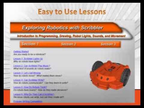

Looks like they had lots of fun! Great photos and all of Ken's code and Parallax teaching materials are there for download. Check it out.
Looks like he used Nikos' four S2 dance and my Binary Counting code too!
And of course he got in a plug for for the S3!
Edit - Ken had some info in his presentation about www.exploringrobotics.com It is a company that makes education material for different age levels and uses the S2, BoeBot and some other bots. Below is the video for the Middle 5-8 grade program. Also the High School bot uses the S2 - and Fluke 2 (which I did not know about) to teach Python programming! I knew that the Serial port was retained for compatibility with the IPRE Fluke - but I thought it wasn't around anymore...Who knew?
[video=youtube_share;wmbEMrclUmU]
Since the S3 will also us the GUI - I want to keep developing some great lessons that use the GUI alone. This is such an exciting way for beginners to start and such impressive work can be done using on the GUI. So - I hope to post more soon here as a way of building a store of ready to use GUI programs for the the Scribbler family!
