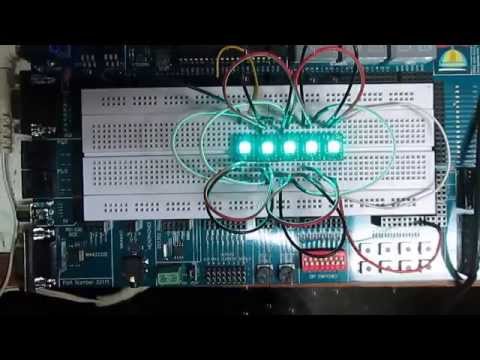

    Just soldered up my five free boards at 6:00 AM. Sweet!
    First use of new PPDB. At least I know P16 works! :)
    (Using Jon's demo)
