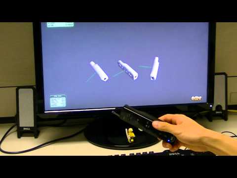

    Here's a video with some source code links to a few implementations:
    In the video, he's obviously not using the compass in the DCM, so it drifts badly. My own version does not drift nearly this much, and once the compass is integrated in, there won't be any heading drift at all.
