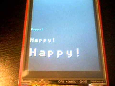

    Hi.
    I've spent some time this morning making a demo for the subject TFT (the SeeedStudio 2.8" V1.0 model).
    The demo only writes to the screen at the moment, and it uses LMM mode (CMM mode is excruciatingly slow). A PASM driver should be created to speed things up (result would be 6 or more times better performance over LMM).
    The attached .zip file should allow you to repeat the same results I get with the Propeller ASC(+) board.
    Here are some useful links.
    Propeller ASC Schematic.
    Seeeduino Schematic.
    SeeedStudio 2.8" TFT LCD module V1.0 page.
    SeeedStudio TFT code examples (the video demo code comes from here).
    SeeedStudio TouchScreen driver (not ported yet).
    [video=youtube_share;edodNm8n1IY]

    David, the video background music is MIDI. The live acoustic arrangement is better ;-)
    NWCCTV wrote: »
    Will this work with the SeedStudio 3,2" TFT LCD?
    That most likely requires a different driver.
    Maybe someone who has the display will port the code. The 2.8" example I posted needed very few changes; just look for PROPELLER in the source.
