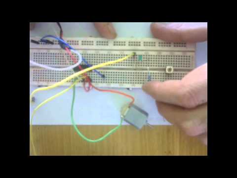

This QuickStart board is half broken , or I've done something to it when soldering. The even pins are odd. I cant use an even pin in my code, no mater which header I inset the wire into I get no voltage. Also yesterday, just touching the pads on the quickstart made them light up, they don't seem to want to do that anymore ? I had tried to use the motor controller chip SN754410NE but the motor would not budge. I gave up. Now I know it was because I was using even numbered pins . Sorry the video is not great.

    The QuickStart has a 40 pin header and these are number from 1 to 40 but the Propeller has 32 I/O pins numbered from 0 to 31. The 40-pin header numbers don't match the I/O pin numbers. I'll find a chart and add it here.
