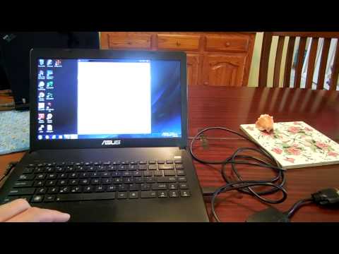

A few weeks ago I mentioned that I was somewhat quiet in the forum because I had been bitten by the retro computing bug. Heater expressed come curiosity about what I was up to, and I'm finally getting around to writing something. I was slow in doing that because work has been pretty crazy too.

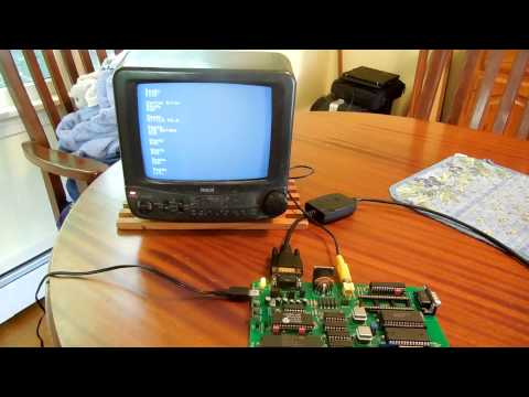

My retro computer is a 6502 computer with a video display, 22 GPIO pins, a joystick port, a serial port, and expansion bus. It turns out there are many good designs available on the 6502 forum, which made this project much easier than starting from scratch. You still need to learn the ins and outs of address decoding, memory mapped I/O, and debugging on a bare metal environment. In order to program the computer I built an EEPROM burner which I just documented here:
I've used that to put a machine language monitor and something called ehBasic on the board. So far the programs are pretty simple things like blinking an LED. Here's a code sample:
10 REM Set up common VIA2 constants
20 PB=$7f60
30 DB=$7f62
40 REM Set VIA2.PB0 as output
50 BITSET DB,0
60 FOR X = 0 TO 16
70 BITSET PB,0
80 GOSUB 200
90 BITCLR PB,0
100 GOSUB 200
110 NEXT X
120 END
200 REM Delay loop
210 FOR Y=1 TO 50
220 NEXT Y
230 RETURN
What's next is using the 6522's one shot timer to allow toggling pin in the background and generate servo and stepper motor pulses.

    Here's a video showing the video output and the LED blink sample on one of the GPIO pins.
    edited 2014-07-20 21:06
    Cool. That is a neat looking board. Yes, wire wrapping things like that is a drag, I did quite a bit of that when developing boards back in the early 1980's. But if you get into "the zone" it can be quite relaxing. Like old ladies knitting or something:)

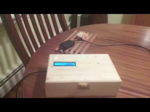

  • In case anyone is curious, my retro computer now has an SD card reader and case:
  • ercoerco Posts: 20,256
    edited 2015-10-26 04:01
    Beautiful! Love the box and modularity. Keep at it and keep updating!
