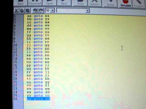

    In the extreme case, here's a program which is nothing but GOTO commands, a fairly useless program, other than making an interesting animation in the simulator and upsetting the purists.

    edited 2014-07-10 08:28
    erco, what is that a simulator for (what platform)?
  • ercoerco Posts: 20,260
    edited 2014-07-10 15:41
    Picaxe. Busted! :)
