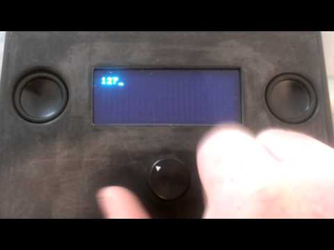

Hello all,
This is my first time having the prop play WAV files, and I seam to have hit a brick wall.
I have been trying to find a way to stop the current (playing) WAV file, and play something else. Right now, once the first file is done playing, the next one will start. I don't want that. I don't want to wait until the other file is done playing.
I have tried
      IF AUDIO_FILE <> NULL
        AUDIO.OVERRIDESONG(TRUE)
        AUDIO_PLAY(AUDIO_FILE)
PRI AUDIO_PLAY(ACTION)
  RESULT := \AUDIO.PLAY(@@AUDIO_LIST[ACTION])
I know there is something I am missing, but I just cant see it.
Thanks for any ideas
TC

    Here is a video of what I am talking about.
  • TCTC Posts: 1,019
    edited 2014-07-07 18:06

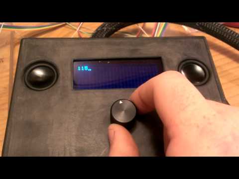

    Well, I figured out how to end the current audio file, and start it again. Now no matter how fast, or slow you turn the encoder knob, the audio matches.
          IF AUDIO_FILE <> NULL                             ''DOES AN AUDIO FILE NEED TO BE PLAYED?
            AUDIO.OVERRIDESONG(TRUE)                        ''END CURRENT PLAYING AUDIO FILE
            AUDIO_PLAY(AUDIO_FILE)                          ''PLAY NEW AUDIO FILE
            [COLOR="#FF0000"]AUDIO.OVERRIDESONG(FALSE)                       ''ALLOW NEW AUDIO FILE TO BE PLAYED[/COLOR]
    What I did is turn off "OVERRIDESONG" right after I requested to play the audio file.

    Cool TC, how about a youtube video with it fixed?
  • TCTC Posts: 1,019
    edited 2014-07-08 14:14
    I was so happy I figured out what to do, I compleatly forgot to upload a video. Here you go
  • base2designbase2design Posts: 78
    edited 2014-07-08 15:53
    Very nice. Thanks for solving this... I'll benefit from your question eventually.
