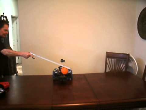

I am working with a Stingray robot that has a Raspberry Pi bolted to it. The Pi serial port ttyAMA0 is connected to the Propeller to pass object tracking data from a USB webcam.
The serial tracking data is sent after every captured video frame from a Python program that is using OpenCV2 to mask a particular color (orange in this program).
Then it sorts out the x, y centroid of the largest detected orange object in the video frame and sends a flag of !& then a byte each of the x, y screen location. Then a word z showing how
large the object is to the Propeller. This video only shows the Stingrays rear x/y camera platform trying to keep physical track of the detected object. I am attaching a test program that
displays the tracking data x, y, z and the FPS(frames per second) in the Parallax serial terminal called RaspiPropTest.spin. The attached Python program called Detect.txt should be saved as
Detect.py to the Pi. With the Detect.py program I get ~ 12 to 13 FPS because I am displaying the small video's on the Pi HDMI monitor. The Rasbian OS on the Pi causes the frame rate to
fluctuate. An example is when you move the Pi's mouse the frame rate drops to around 7. The best I've been able to get is a little over 14 FPS with frames resized @ 110 by 80.
The video has to play full screen to see the x, y camera platform on the back of the Stingray try to follow the orange ball on top of the Scribbler2. The ball falls off the Scribbler and the camera
keeps track. In the end though as I am waving the ball around with a grabber it loses track. I attached all of the programs I'm using as I am just starting on this adventure. The center method
and command when removed and the blocked out portion restored of the top Spin program in the zip file is my current experiment with moving the whole Stingray to try to track the orange ball.
Sorry if you can't see the camera platform moving in the video.

    This video is a little better to see than the last one. It is still using the Detect.py from the first post. One thing I learned is consistent lighting is a must. It also helps to have no
    color close to your set color in the picture other than your color object. I made the Spin program wait until it reaquires an object before it moves the AX12's. It is still slow tracking.
    I have been trying to build a C++ program on the Pi with OpenCV but with no luck so far. It will be interesting to see what Bill comes up with using the Raspberry Pi camera.

    I was able to get the Stingray's arm to follow the object vertically and the whole robot to keep the detected object in the middle of it sight. The area returned can change depending
    on the light source and fluctuates too much. So I was unable to use the camera so far for distance following like I did with a pair of ping sensors here.

    great resolution with about a second of latency. The frame rates shown for both camera's the picture size is 320x240. Smaller videos sizes increase the frame rate. When I use 110x80 for
    object detection the frame rate flickers between about 15 ~ 30 FPS with sending serial detected object info from the Pi cam module. The .txt is supposed to be .py .
    Edit: Answered next post in the thread listed.

    Whit a little more detail about my setup than I gave in the other thread. For that last video I posted the Raspberry Pi B+ is setup to run the Python program det.py at bootup.
    As for the Spin program stngfllw.spin I used SimpleIDE Version 0.9.64 on the Pi to load the program to EEPROM via USB. The R-Pi is powered from Stingrays 5v on the P1 connector.
    So when the power switch on the Stingray is turned on both boards start, the Stingray finishes first and waits for data via USB from the Pi after it finishes booting.
    I have a wireless keyboard/mouse USB dongle and a wireless WiFi USB dongle. So I can work on the Pi directly with a HDMI monitor connected and/or a ssh connection to my
    computer via WiFi. When I mentioned what I was doing with the WiFi dongle in the other thread you can also use it to connect and control the Pi from the internet. I have no idea how
    to do that at the moment. I will be happy to answer any other question you might have (if I can!). Have lot's of fun with your project Whit!
