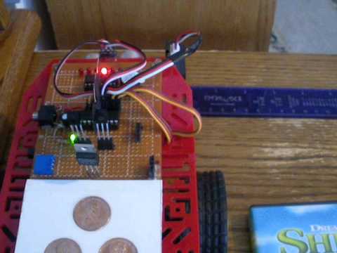

    I really like those Sharp I sensors, I've stockpiled ~30 for a project. They are an analog sensor and require an ADC to read them, but in a pinch you can use them as a digital proximity sensor, using the I/O pin as a comparator. The pin's TTL low/high threshold sets the distance, per this video. Hey, at least I used a Parallax ruler!
    I'm sure there are ways to adjust the trigger point with these sensors. A voltage divider would be an easy way to reduce the trigger voltage (I forget if the voltage if directly or inversely related to distance). I'd think some sort of capacitor to Vdd tied to the signal line would be used to increase the voltage trigger. I suppose by the time you go to this effort you might as well add the components needed to do a proper sigma-delta measurement.
