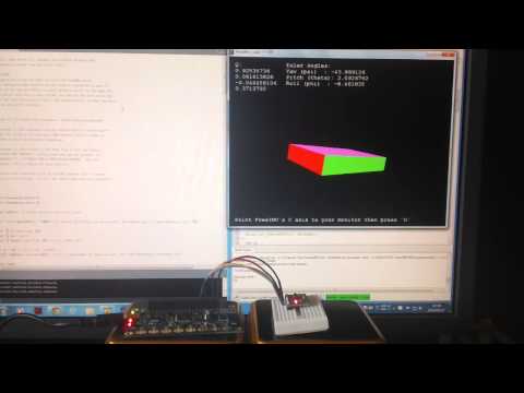

Hi, I am a newcomer for this forums and quite beginner for propeller.
I bought Propeller P8X32A QuickStart and MPU6050 recently and I am trying to transfer FreeIMU_quaternion.ino (Arduino code) + FreeIMU.cpp in Varesano.net to Propeller C.
I have succeeded to communicate between QuickStart and Proces55ing 1.5.1.
But quaternion data itself is not stable.
Plate starts rolling after 0:40.
[video]https://www.youtube.com/edit?o=U&video_id=6PU42hfmA_Y[/video]
I guess this is caused by improper proportional/integral gains or bad reading in I2C communication.
Does anyone help me to fix this ?

Does this rotation occur each time you run the program? If so does it always occur at the same time from the start?
I'm wondering if it's caused by a 32-bit timer rolling over. An error this drastic doesn't seem like it would be caused my P. I. parameter not being set correctly. Your sensor is stationary correct? If so, I don't think the P. and I. parameters really matter.
Thank you for your comments.
I have checked with Arduino UNO + MPU6050. And confirmed this combination works OK, no rotation occurred.
Yes, with QuickStart + MPU6050, rotation occurs each time, but it does not occur at the same time from the start. Sometimes it occurs from the beginning.
In comptation of quaternion, sampleFreq is calculated as follows;
now = CNT / (CLKFREQ / 1000000.0);
sampleFreq = 1.0 / ((now - lastUpdate) / 1000000.0);
lastUpdate = now;
I amended to comment out these and sampleFreq = 12.0; , then tried, but rotation still occurred.

I was able to stabilize the cube by using a better "mircos()" methodology.
That is, in getQ() replace this code:
//now = CNT / (CLKFREQ / 1000000.0); static unsigned long _time = 0; unsigned long rc = (CNT - _time); _time = CNT; now = rc/(CLKFREQ/1000000);
The Cube still wanders slowly, but it never flips like in your video. Hope this answers your query.

Unfortunately, my cube is still rotating in every 3 axis, even I use your better "mircos()" methodology.
My board is QuickStart with CMM Main RAM Compact and -Os Size Optimization.

I'm looking at it now... what I find is that very reliably, there is an increasing error in the reported roll axis this magnitude of error increases until -45degrees then changes what appears to be a steady rate error to around -90 degrees and decelerates to about -154 degrees... the error then reverses values (increasingly heading from a - direction toward zero) but never gets back to 0 roll angle. If I move around an axis, the amount of movement seems to translate wrong... possible from a faulty assignment of radians rather than degrees. I didn't have time to look for it. Sorry.
So... there seems to be a constant that has the wrong value and an equation that has mixed up radians and degrees... but I could very easily be wrong.
In your getValues function you have values = accgyroval / 16.4f;
I would look carefully at that 16.4 value and see if it is in error. I have no idea where it comes from and I haven't played with it's value. I did play with Steve's timing changes. I put a constant correction into the getQ's sampleFreq = 1.0 / ((now - lastUpdate) / 1000000.0); to sampleFreq = 1.0 / ((now - lastUpdate+constant) / 1000000.0);
and changed the value of the constant, but it didn't seem to do anything significant... again I could be wrong. I'm tired and bouncing from issue to issue tonight.

I am afraid but I misunderstood your better "mircos()" methodology code.
Now my cube is stabilized
Thank you very much for your great advice and help.
My cube also wanders slowly, but this is also occurred with Arduino("FreeIMU_quaternion.pde").
But here is another problem, the cube in Processing screen responds to GY-521 module rotation in Pitch and Roll, but NOT in Yaw.
I checked with Arduino("FreeIMU_quaternion.pde") and the cube responds to all Yaw, Pitch and Roll.
