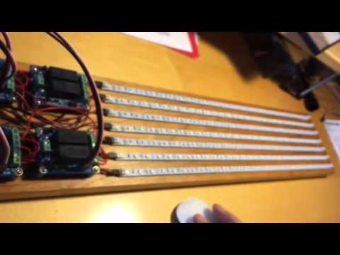

Using a Propeller BOE (or any board with the right microphone circuit) I'd like to be able to detect and bin the sounds into each note, maybe even identifying sharps and flats. Put seven LEDs on a breadboard and activate each one of them based on detecting an A, B, C, D, E, F and G note. Bonus for detecting sharps and flats, too! A whole bunch of apps for iOS make it a built-in tuner with a lot of precision, but there's not a way to control anything from within their hardware.
Like most other projects, I'm sure this has been done already for another microcontroller. I've never looked inside of a tuner.
Eventually I'd drive much larger circuits, maybe with addressable LEDs, LED light tape, and who knows what else [except a quadcopter]. It's a way of combining one hobby with another. But the first step is what this project is all about - identifying the tones.
It would be ideal to see the application be configured for all kinds of instruments and transpositions, but this isn't necessary right now.
Chip says I've got to learn to use FFT to do this properly. Yet I've been sitting on this project for six months and I haven't been able to study it a bit. Sometimes engineers walk by my desk and tell me how easy it is, yet the code hasn't written itself as easily. My lack of progress isn't due to lack of interest, though it's true that my programming skills are about the same level what we share on Learn.parallax.com and I have only negative time lately. So I need some help.
I thought it would be fun to build a Propeller BOE test project area with some relays and several LED strips, and a VGA display for feedback. Never mind the clicking relays - I know they're silly but they were the first piece of hardware I could find. Moving forward I'd use MOSFETs or something digital. Feel free to make fun of me for using them, though. I'll probably step back to a simple board with LEDs and PST to get started. I'm not even sure I want to use the hardware in my video now that I hear the relays. That's the last distraction I need at this stage.
C, ASM or Spin? Don't care! I can test every piece of code you produce.
