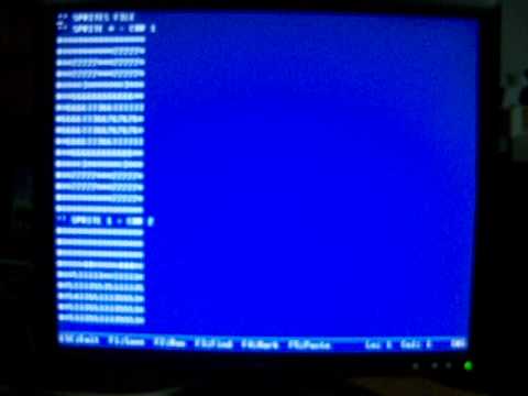

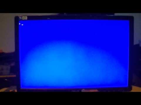

    I finally got a chance to record some videos of the project in action...
    Here's part 1
    edited 2014-06-19 18:42
    Part 2:
  • David BetzDavid Betz Posts: 14,516
    edited 2014-06-19 20:05
    Nice videos! Did you have to change the firmware in the Micromite to do any of this or are you just running the stock firmware that comes with the chip?
    edited 2014-06-19 20:07
    Nope.. It's running stock 4.5c (current version) -- I thought yesterday I might have to jump from stock, but I was able to get things working without doing so.
    Jeff

    edited 2014-07-30 21:42
    I thought the software side of the project could a fun side, not just the 80x30 character display.
    The programming code you'll see is MMBASIC, but it's controlling the Propeller for sprites and tiles, making the Propeller's magic very accessable.
    The Propeller is using the Propeller Graphics Engine. by MaccaSoft.
    I've modified the code to accept the sprite/tile data from ascii files as shown in the video.
    If you can use I2C controlled Propeller VGA graphics & sprites system for your project, you are welcome to the code.
