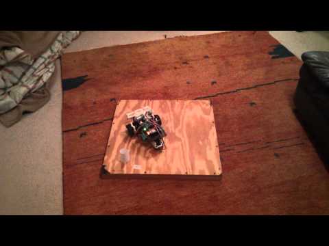

Prologue:
I started working on my first robot approximately forever ago. The Goal is to build a robot that can locate a 1.5" cube on a ~1.75' X ~4' table, without falling off, and then relocate the cube to a 3" red paper circle[taped to the table].
I'm using an Activity Board for the controller.
So far it can find the block.
Now I need to add an H-bridge (plus a few things), and wire up my DC motors. I think I have a fair bit of it figured out, but I'm concerned about the two NPN/PNP transistor pairs [bottom of the diagram below]; what I want to accomplish, is to have 1 prop pin translate to 2 pins, 1 of which will always be high, and the other low.
so you have line A, and B controlled by a prop pin(P)
P|AB
1|1 0
0|0 1
I'm sure people do this all the time.
Really I appreciate any feed back.
