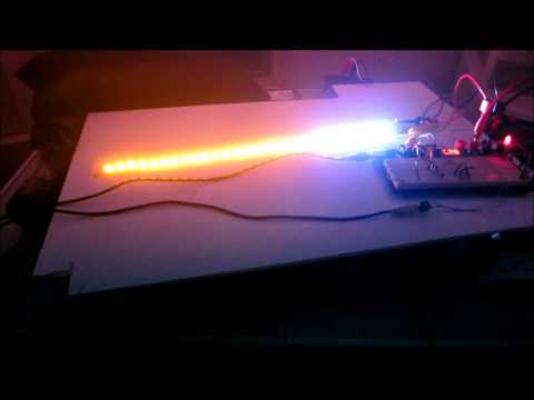

  • Propeller Microcontroller
  • MCP3002 ADC
  • WS8211 72/m RGB LED strip
  • Logic level shifter
  • 4 resistors
  • 2 capacitors
I currently have one channel working and will add the second channel next. I also have some better effects to integrate. Also I think my output is linear and needs to be logarithmic.
[video=youtube_share;dqCtIZwMXPw]
The camera doesn't work so well with all the flashing lights, but my next routines help a lot.
Big thanks to JonnyMac and whoever wrote the demo code for the ADC. It's great to be able to control a lot of LEDs without having to do a lot of soldering, the WS8211 strips are great for that and the Propeller handles them with ease.
The code below is a different effect than the video, and needs some work.

  • xanaduxanadu Posts: 3,347
    edited 2014-02-13 17:14
    The code runs like this:
     repeat
       left := adc3208(1) 'read ADC and return variable
       strip.fill(0, left/6, strip#blue) 'fill the strip to match variable divided by 6 for scale
       strip.set(left/6, $FF_00_00) 'add a red dot to the current meter position
       pause(1) 'makes it look better
       strip.fill(left/6, 32, 0_0_0)  'turn off all LEDs past the current meter position
    edited 2014-02-13 19:19
    This is really cool! Nice integration of pieces parts!
    edited 2014-02-14 21:38
    You are right, it does need to be logarithmic. Looks good now, and should look even better with log response.
    edited 2014-02-18 10:53
    Thanks! Adding channel two as we type!
    edited 2014-02-18 11:06
    kwinn wrote: »
    I was able to implement a logarithmic response by using horrible coding instead of proper math. I used a bunch of IF statements. For example-
    IF left =< 9
    'turn first LED on
    IF left => 10 AND left < 20
    'turn second LED on
    IF left => 20 AND left < 30
    'turn third LED on
    Effectively the power has to double to light up the next LED. I'm assuming that is how standard log taper works but working on that aspect as well.
    If anyone has any comments on how to do that better I'm all ears.
    edited 2014-02-18 21:23
    I thought there was a log table in prop rom. If so you might be able to use that. If not a case statement might be more readable even though it would do the same thing.
    edited 2014-02-19 08:52
    Thanks kwinn. I found the log table in the Prop manual, will try to use that, if not case.

    I added the second channel and also a three point logarithmic response curve to the output. It looks better but since it has so long to go I thought I'd share an update.
    [video=youtube_share;i0-VT5XDB2E]

    Good day, ladies and gentlemen. I bring to you project #522 (unfinished project #217 and #305).
    [video=youtube_share;fJ3FbF0lbqA]
    ^^Please watch this at 1080 or it will seem out of foocus.
    Still working out some kinks. Still waiting for parts for Xanadu Industrial Aēchos Rover 1! In the meantime all other aspects of life have been calling.
    I'm going to black out the LED strips next.

    For stereo you need two channels of ADC for each range of frequency you want. I ordered some MCP3008 awhile back to start playing with spectrum/EQ style display. Eight channel ADC divided by two channel audio give four different sets of inputs you can drive from the same two channel source. I am pretty sure all of this needs to be done on the analog input side of the ADC. I don't think there is any other way, at least using what I have to accomplish it.
    On the input side of my two channel ADC I have toyed around with using RC filters to isolate low, medium and high freqs, it seems to work well. When I start to add all of this to an already busy WS8211 strip it starts to go south. I know a lot of that problem lies within my code, and what I'm working on now is this:
    Low pass = red; band pass = blue; high pass = white. There is a lot of tinkering... er.. calibration in getting them equal, for instance the low pass doesn't give me close to the ADC value as the high pass.
    I think I will post that version next. I just need to close out a few hundred trouble tickets first ;)

    When it comes to music, the audio spectrum is full. To allow for a graphical representation of this spectrum would require many individual channels. More than I wish to make. With only two channels to spare, I had to improvise.
    I cut my project down to monaural for now, as a proof of concept. The red channel represents a 6 dB/o roll off above 160Hz and the green represents a 6dB/o roll down to 482Hz. The values are as close as I have parts as of now. You’d think all those capacitor and resistor assortment packs would get you somewhere with audio, but they don’t, I have drawers of components and unless I’m missing something I still don’t have what I would need.
    I’ve included a very long and drawn out sweep from 20Hz to 20,000Hz as well, feel free to skip around to see the LEDs transition.
