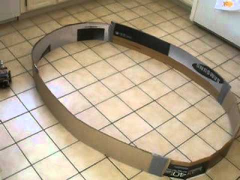

    edited 2014-02-04 11:31
    Here's a video of it wall following:
