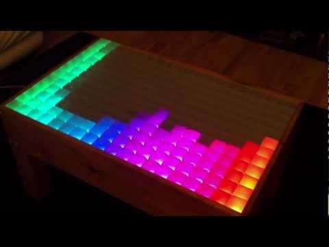

Hello all, I was surfing YouTube and came across a LED table. After a few more videos, I found this one. My wife looked up from her book and said "I want you to make that!" In our 15 years of marriage she has never been that adamant about a project she wants me to do.
But, I have a problem. I have no idea where to start, what should I use (MPU, drivers, etc.), how to do the patterns, etc... Building the table is no problem (wood, plastic, metal, etc), and making very simple LED patterns I can do, but I don't think simple patterns will work for this.
Any insight would be great.

    Yeah, don't do it. I mean monitors are way cheaper and slim, just build the frame and legs and run it from a RPi as there are plenty of visualizers available. Use a polycarb sheet over the top to protect the screen. You could even play games on it, especially board and card games.

    it's 19x12 RGB LEDs if each pixel cost you $1 = $228
    So 32" LED LCD TV does cost less at $179 http://www.walmart.com/ip/SCEPTRE-X322BV-HDR-32-LED-Class-720P-HDTV-with-ultra-slim-metal-brush-bezel-60Hz/25059351?wmlspartner=*7WaaTN6umc&sourceid=20164897472754624023&oid=268135.1&affillinktype=10&veh=aff
    But if you can get the cost down for the rgb_led+diffuser, it's still cool factor.
    edited 2014-01-15 19:20
    Yea, that design as shown is about 240 RGB LEDs. RGB LEDs are typically pretty expensive, but you can get them cheap off eBay, erco style: (http://www.ebay.com/itm/50-pcs-Ultra-Bright-5mm-4-pin-RGB-Diffused-Common-Anode-LED-Red-Green-Blue-/130918069818?pt=US_Car_Lighting&hash=item1e7b53363a) just make sure it's the 4-pin kind and not the ambiguous 2-pin-flashing ones.
    As for driving them, you'd need to multiplex 3 grids of 12x20 (1 red, 1 blue, 1 green). It is possible to do, but you'd need a lot of shift registers, demultiplexers, and LED drivers (preferred to driving them with the shift registers). A project of this magnitude would be too much for a BS2, but a Propeller should be capable of handling it.
    As Peter said, you'd probably be better off just buying a screen if you aren't needing to go for that authentic homemade look.

    I'm wondering about doing something similar myself. I've been experimenting with 8x8 RGB LED arrays in preparation to possibly using them in a table.
    I think the larger pixels of the table shown in the video would be easier to control than a 64x64 pixel (or 100x100 pixel) table top.
    edited 2014-01-15 20:09
    I've thought about doing a coffee table project when I get some time as well. Can't make up my mind between an LCD screen so it can also be used for games or a 20x12 RGB led array for patterns/mood lighting. Cost of LCD screen and LED array are comparable.
    The led hardware is not that difficult, basically three sets of four 8 bit shift registers. The software though is a bit more difficult, but I am sure a prop could handle it.

    After mulling this idea over for a little bit I am starting to lean towards the led approach. I'm picturing a version of the game of life running as the "screensaver' when not running a game or other app. I wonder if it would be feasible to add capacitive touch to each pixel.

    One of the things to consider is if you want to be able to control the brightness of the individual pixels.
    I've been playing with MAX7219 chips lately and I think they are fun but I still prefer to use high power shift registers. With a PASM driver, the shift registers should be able to give pretty good color depth with that size of an array.
    The MAX7219 let's you update a just 8 of 64 pixels at once but I don't think this is very useful in this sort of project. I think a '595 type shift register would allow faster updates of the screen (to allow PWM blending of colors).
    I'd suggest keeping the enable pins of the shift registers accessible to allow brightness control without losing color depth.
    Depending on how bright you want the table to be, you might need to use a '595 chip to control some sort of transistors if the high current '595 can't handle the loads directly. I doubt you'll need to do this though. I bet the big brother of the chip I'm using would probably work for this project.

    WOW!!! All the ideas.
    I talked with my wife, she said "No way are you using a TV for a coffie table. If I wanted that I would just put ours on boxes and it would be done. I want how it is in the video"
    So, with her saying that, looks like LEDs all the way. YAY!!:lol:
    I was wondering, what does everyone think of using WS2812 LEDs? I found 250 of them, from eBay for $62.95USD + free shipping from New York. I know I have seen people drive a lot of them at one time, but I don't know if the prop could drive 228 of them.
    Also, how did they do the visualization? I don't think someone sat there and coded every single frame (that's the only way I know how). Im assuming they used some form of FFT (still don't know how it works).
    I really like the idea of touch sensor. and of doing a Game of Life. Don't know how to do either.
    Please keep the ideas, and knowledge coming. I have only done simple stuff, mostly with the BS2. I am just starting to get a small grip on the prop (still cant get past 1 COG). I think this project would help me more, and help to keep me out of the dog house.

    Glad you've got the green light for LEDs - pun not originally intended... I've used the 7219 to drive 2 8x8 matrixes of LEDs from a single BS2. It's a little tricky for a novice but I have code that might help. You will need three matrix drivers, one for each R, G, and B. I agree that a Propeller would be an easier setup IF you have Propeller experience... but you could also use three BS2 chips I suppose, communicating between each other! :) I noticed a lot of folks immediately focused in on cost - but if that's not an issue, I think you can make this into a really cool project. Fresnel lens diffusers on each cell, all sorts of stuff. Keep us posted!

    Let's see it is 12x19 matrix. Are you going with one color or three colors? That will decide a lot of what you need to do both in terms of construction and programing.
    Oh, this is going to take quite a bit of power as well... but don't rush into buying a power supply until you are sure how you are going to drive the matrix.
    Fast Fourier will allow for modulation to audio input, but it is one of the last pieces of the puzzle you will need to get into place.
    If you are using three modulated colors on each LED, you may just have something better than the video. You may not have noticed but none of the LEDs are changing color in the example. They just blink on and off.
    edited 2014-01-16 08:01
    TC wrote: »
    Those LEDs only take a couple of pins. They are addressed serially.
    Instead of individual LED, I would suggest getting them in strips:
    http://www.ebay.com/itm/144-LEDs-M-WS2812B-Chip-Black-PCB-WS2811-IC-Digital-5050-RGB-LED-Strip-Light-5V-/310775026322?pt=LH_DefaultDomain_0&hash=item485ba29292
    This would save a lot of time soldering, and you would have to add one resistor and one capacitor to each LED, as shown at the bottom of this Data Sheet.:
    http://www.adafruit.com/datasheets/WS2812.pdf
    You will also be looking at a 6-8 Amp power supply.

    I will keep everyone updated on my progress. it will take some time to get up the money, and to learn how to program it.
    My wife wants to keep it RGB, she likes the way it looks.
    I am a fan boy of the MAX7219, but I don't think it will be good for this project. The 7219 only has 16-bit global brightness, My wife wants it to be like the video. Where one pixel is different from an other.
    I have seen the strips of WS2812, and I might just go that route. Because even if I make boards 1/4sqin (smallest OSHpark can do) i would be looking at around $100 just for the boards.
    I don't want to get neck deep in this project and find out that this cant be done exactly like the video. The thing that grabbed my wife's attention was the visualizations, like what is on iTunes. That is the thing that has to be able to do. The other stuff, like Game of Life, spectrum analyzer, some form of input for simple games are up to me.
