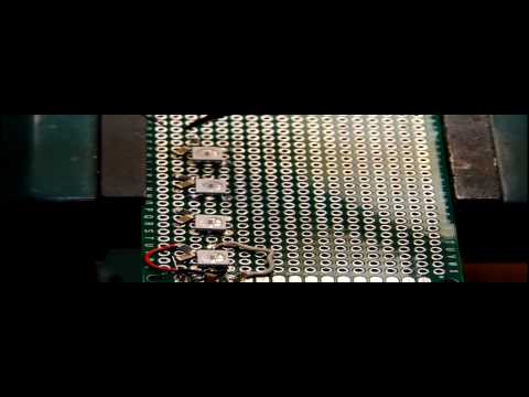

Actually came across your video as a youtube recommendation after uploading and was wondering if OSH park
cuts out the circular boards or do you have to do that after you get them?
No I haven't seen the b version, I assume it leaves off the reference voltage and the extra unused pin? That would
greatly simplify the wiring.
They come back from OSH Park looking like the board on the left.
I carefully cut out the center disk and use a Dremel to clean up the edges in order to get the board looking like the one on the right. The top board was cleaned up the same way and then populated with caps and LEDs.
The gerber files had the center section completely cut away. I'm not sure why OSH Park (or the fab house) left the material connected with tabs. I drew the inner circle on the board outline layer (or something like that, it's done with the same tools as the silkscreen shapes, not the "Board Outline" tool).
Yes, I think the B version is easier to mount but I haven't tried soldering any of the normal (A?) LEDs so I can't compare the difference.
The down side to not having a voltage reference is the glitches caused by the 3.3V logic. These are the only 5V devices I can think of where I've needed to use a level shifter in order to use it with 3.3V logic.
I copied AdaFruit's ring layout and only included a cap between every other LED. I don't think I would have had room for a resistor if I had wanted to use the A variety of LEDs.
