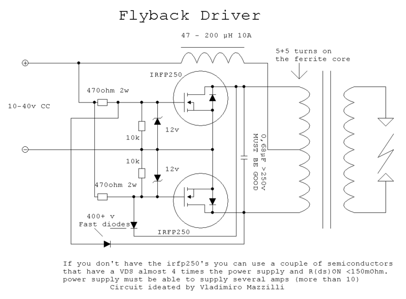

I have used the circuit below: (See: High Power Drivers)
http://wiki.4hv.org/index.php/Flyback_transformer
http://wiki.4hv.org/images/thumb/8/8a/Mazilli1.png/800px-Mazilli1.png
With slight modification to the circuit:
Omit the Zener diodes
replace 10k resistors with 6.8k resistors
replace 470 Ohm resistors with 1k resistors
Power the unit with 6 Lithium Polymer cells (22.2Volts)
Transistors used were four IRFZ44N's ... each transistor was paralleled and run cool to the touch in this circuit.
The center taped inductor is roughly 40 turns over a 2.5 inch diameter form
The primary is literally 10 total turns of wire center tapped. Balance is important here for good resonance, So I used 16 gauge lamp cord already paired together. I brought the opposite ends together 'after' winding to create a center tap. This provides a better mechanical as well as electrical coil balance as opposed to winding two separate 5T coils. Using the lamp cord to keep the windings together, interleaves the two 5T coils for better matching.
While the value of the capacitor isn't particularly important (i.e. the circuit will generally resonate at a frequency determined by the L and C value regardless and dynamically adjust to any load on the primary and/or secondary) what is important is the voltage rating. Even though there are only 10 turns total for the coil, I have measured in excess of 300V across the coil. I used three 1 uF 250 Volt caps in series to form a single capacitor approximately 0.33uF. This stays cool to the touch also.
Anyway, the goal with this circuit is to obtain a plasma arc .... If you have some other means it will also likely work.

    Beau, your use of an air-core inductor with the Mazilli driver is brilliant. It simply and cheaply addresses the chronic problems of core saturation, excessive dissipation, and expensive ferrites. Is this your idea?
    I'm stealing it!
    edited 2013-12-07 11:31
    User Name,
    I chose an Air core because they are just easier to wind.... The schematics called for an inductor, So I just tried a few... 40T around a 2.5 inch form seems about right for this design using a 10T center tap. It still blows me away a bit that all of the energy coming out of the FBT is a result of what you are putting into the 5T coil. Yet everything runs surprisingly cool.
