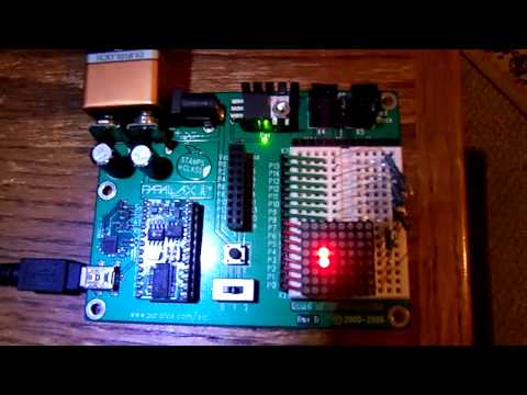

    The small arrays I ordered over a month ago arrived yesterday. I wanted to use the PCB that came with the larger array to control the small array. After using some wire connectors between the PCB's socket and the pins on the small array, I found the two arrays did not have matching pinouts.
    Using your diagram as a guide I soon found the anodes and cathodes of the arrays were opposite from each other. I've attached my edited version of your diagram to this post. I just used MS Paint to swap the red and black squares.
    To wire the small arrays to the MAX7219 PCB, I swapped the row and column pins.
    Here's the conversion using the notation from your diagram (the first position is the position of the PCB header the second is the position of 788BS array):
    PCB Pin #, PCB position, Array Position (788BS pin #)
    1, R5, C5 (pin 6)
    2, R7, C7 (pin 15)
    3, C2, R7 (pin 2)
    4, C3, R6 (pin 7)
    5, R8, C8 (pin 16)
    6, C5, R4 (pin 12)
    7, R6, C6 (pin 11)
    8, R3, C3 (pin 4)
    9, R1, C1 (pin 13)
    10, C4, R5 (pin 1)
    11, C6, R3 (pin 8)
    12, R4, C4 (pin 10)
    13, C1, R8 (pin 5)
    14, R2, C2 (pin 3)
    15, C7, R2 (pin 14)
    16, C8, R1 (pin 9)
    I'm currently uploading a video of the small arrays scrolling text. It also shows the wire harness I used to connect the array to the PCB.

    Using Beau's diagram, I rigged up a bunch of wires to use the MAX7219 boards to drive the small arrays.
    Here's a video.
    The whole anode cathode swap thing seems kind of strange. They both can be driven with the same ICs (I hope), but the wiring just has to be switched around. I wonder why there's two different versions?
    Edit: It just occurred to me, there's a lot more (up to 8 times) the current going through the row pins. It will make a difference which version is used. I hope the common cathode anode version isn't going to damage the MAX7219. Should these be driven with a different chip?
