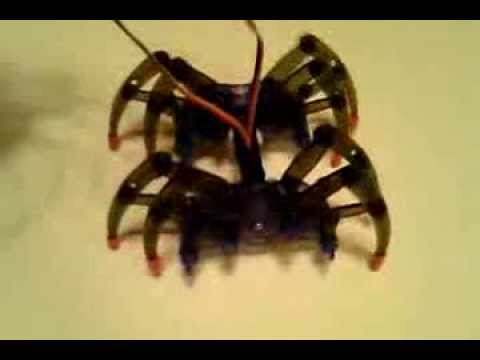

Following Amanda's lead, I named my new robot per his main feature. She has Ted Tread and Wally Walker, so I have Spike Spider.
First test of modified Spider Robot chassis. ~$8 on Ebay: http://www.ebay.com/itm/200955719259
Two HXT900 servos modified for continuous rotation do the driving. No controller or sensors yet, just a simple servo tester used here. Servos are driven in opposite directions, so it just turns in place. More to come.

    Erco, how did you couple the servo output shaft to the geartrain that was already in the robot spider? I imagine the input gear was designed to fit over one of those typical toy DC motor shafts.
  • ercoerco Posts: 20,257
    edited 2013-11-20 08:35
    Million dollar question, Pal! It's a hex shaft I cut & drilled out on a lathe; a 3/4" long 2-56 screw goes inside and threads perfectly into the servo screw hole. Slightly better view of the servo glued to one side at http://www.youtube.com/watch?v=aSnp58Uhhug

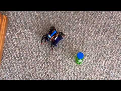

    Finally something to show! First test, just walking in a circle. Open loop here, soon it will track around a center cylinder via ultrasonic sensor.
    http://www.youtube.com/watch?v=oVVGr6kQuHA

    I'm surprised those little servos are up to the task of powering that thing. Very cool. It looks like the original version just travelled straight?
    It seems like a simple task to get it to do a figure 8 now that you've got it going in a circle. Are you trying for the ultrasound challenge first?
    I have yet to make an entry in the US challenge. It's on my todo list (with lots of other things).
    edited 2013-12-30 15:33
    Yes, yes, yes, yes, yes, and yes.

    Is the distance from the bottles pre programmed or is it determined by the initial distance to the two bottles?

    Thanks for your good words, guys. This bot retains one of my favorites features from my laser-guided Terminator bot. It uses just one Li-Ion cell (an AA-sized 14500 here) for power, visible on top of the PCB. A cheap Ebay USB stepup circuit provides 5V for the (noname) processor and sensors, while the servos run direct off the 4-ish volts of the Li-Ion. The little Spider robot has a lot of backlash in the leg linkages and I minimized weight at every opportunity.
    @Duane: Orbit radius was hastily preset for this first run, but it could easily measure the distance and calculate its own radius, since it uses a built-in ADC to read the Sharp sensor. The sensor's "look around" scanning feature is borrowed from numerous other robots, I can't claim any originality there. I could have used multiple stationary sensors instead, but the servo scan motion adds a fun animation to the bot.

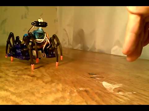

    Ultra-simple tracking routine could be used on any robot, any processor.
    edited 2014-01-26 22:54
    Tracking to an object and maintaining a fixed distance.

    This is neat.
    With my IR compound eye I had left, right, and center zones so I could infer the direction. But this sensor only has one zone. When you move your hand left or right how does it know which way to track? Does it guess and go the other way if it loses the object?
    edited 2014-01-27 21:50
    Another million-dollar question, Martin_H, you're sharp!
    It ain't smart at all. It just oscillates back & forth and stops when it sees a target. But it looks smarter than that when the object moves slowly back & forth, eventually they sync up. It eventually finds any object in range.
