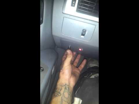

Hotwiring a car is super easy. Not because I am a criminal or trouble maker but I have a dirtbike and work a lot on the engine and of course venture of into the automotive world to satisfy my need for mechanics. I have learned a lot over the years and in principle... it is common sense to someone who is handy electronic/mechanic wise. Like you have stated, I wont explain over the internet and aid someone in doing something stupid. I already hooked a toggle switch and SPDT monetary push button up to the ignotion and disabled the steering wheel lock. I also integrated 2 SPDT monetary push buttons under the wheel well to lock and unlock the car. Here is a video of the toggle switch and SPST monetary push button in action ->
Now how cool would that have been to hook up a key pad so only the possessor of the combo could start the car? That would have been badass!! lol
