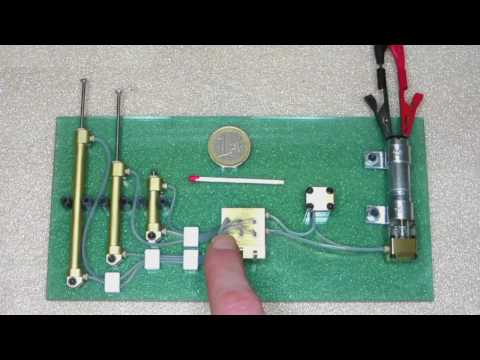

    My initial thought was air pressure via compressor or co2 cartridge but since W9GFO beat me to it and everyone else mentioned probably everything else I'll have to go with micro-hydraulic.
    How cool would a robot with hydraulics be?
    http://www.hobbyking.com/hobbyking/store/uh_viewItem.asp?idProduct=14054
    [video=youtube_share;vvaYTVBHHYU]
