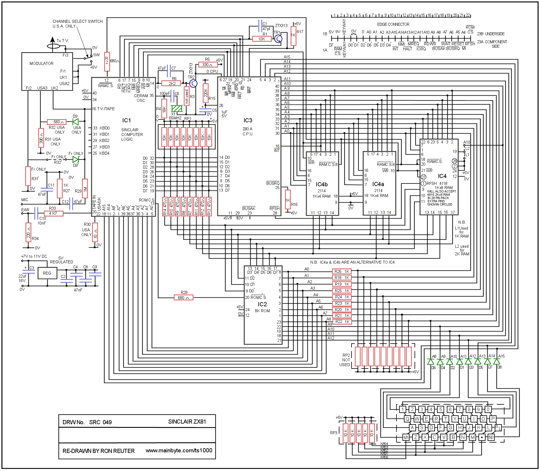

The ZX81 was a marvel for its time since it generated its video using software and ttl logic rather than a separate video chip like other computers. It generated black and white output with a resolution of 256 x 192 in 8 x 8 blocks. They made 3 revisions and they cheated in the first 2 by having no back porch in the video output. In Revision 3 they had put it in since TVs were becoming more sensitive to the lack of a back porch. If you have a ZX81 or Timex Sinclair 1000 and hook it into a AV input to most digital TVs you'll get an almost unreadable signal. You need to find an old TV in a garage sale or goodwill store to get it up and running.
There are a couple of adapters for the TV signal out there but all require opening up the ZX81 and patching hardware into it. The ZX81 has a membrane keyboard that has become brittle with age and a custom chip that fails easily when static electricity hits it. For that reason I do not want to open my one working, never opened Timex Sinclair 1000 to be potentially damaged adding the mod.
Since the signal is only composed of black and white signals it should be able to be "digitized" by using a simple op-amp as a voltage comparator with its output connected to a switching transistor to convert it to logic level voltages. The Propeller should be fast enough to capture the pulses and recreate the bytes. The trick will be in locking into the vertical and horizontal syncs so timing will be correct. Once enough bytes are reconstructed it could be put in a video register for output to a TV to minimize delays. If possible the bytes should also be saved in a buffer so that a VGA driver can output it as well.
Is this a doable project or are there any other approaches of capturing the video output without opening my computer? Thanks!

    If you think the issue is only back porch related, you could fix just that portion of the signal, using a Prop and some analog switches ?
    edited 2013-09-12 21:37
    A monochrome video scan line is approximately 63.5uSec long, and this time includes the sync, front porch, and back porch time. That leaves about 52.5uSec for the video signal, so each of the 256 pixels would be about 205nSec or 4 PASM instructions in length. Might just be possible with multiple cogs, but for sure not simple or easy.
    Probably simpler to do it in hardware with a high speed comparator to detect the sync signal and a one shot (or 2) to modify the video signal. You could use a prop to modify the signal but you would still need a comparator or some other circuit to detect the sync signal.

    One thing, don't forget that the output at the jack is modulated for TV channel 2 or 3. So you will have to demodulate the signal first before you can do anything with it.
    If the keyboard works on yours then DON'T OPEN IT. That is a sure way to crack the fragile ribbon cable.
    I would look at connecting the propeller to the edge connector and writing a video routine that sends the screen data to the propeller. You can intercept the video routine with code (that is how the pseudo hi-res graphics are done). It shouldn't be hard to send the video data to a Z80 port and have the propeller look for data at that port address.
    Because of the strange way the zx81 does video, you might even be able to detect when the zx81 is doing video and sniff the data from the bus.

    Are you planning to have the prop read the data in parallel from the ZX video shift register? If so that makes things much simpler.
    A single cog could use a waitcnt to monitor the “load” signal (IC9 pin 1) to synchronize reading the video byte as it is output to the video shift register. The bytes could then be written to hub memory where one of the video display objects (modified to suit) could access the data to display it.

    It is only when the CPU tried to execute code from above 32K that the ULA takes control. (The lower 32K is echoed into the upper 32K).
    So to start the display the CPU basically does a jmp to D-FILE+32K, this tries to execute the display file.
    While the PC is above 32K any instruction with bit 6 cleared will cause the ULA to force a NOP to be executed.
    At the end of each display line is a HALT instruction (which by chance has bit 6 set) when the CPU reads the HALT instruction is is executed causing the CPU to wait until the hsync signal causes a NMI interrupt breaking it free from the HALT state. (The hsysnc signal is generated by the ULA inself, not by the CPU at all).
    While executing NOPs the I register is used along with the value in RAM to lookup the character bitmap in the ROM.
    In all it is a pretty strange way to generate a display, but I guess in those days that is what had to be done to make such a cheap computer.

    A schematic for the ZX81 can be found here. The tape output IS the TV output put through a RC filter/integrator.

    Basher, The Tape out and Tape in use part of the some hardware and software to generate a signal compatible with cassette players. This does produce "bars" on the screen when the signal goes out but there is no way of using it to stream video out.
    EDIT:
    I just looked at the schematic again and Basher is right. The Video and Audio use the same output with the exception of a couple of resistors, capacitors and a diode (USA).

    The circuit uses a 47pF capacitor, 2 nand gates from IC16 (74LS10), and 2 inverters from IC13 (74LS04). I am pretty sure the load signal could be generated using only a single 74LS10 and 2 prop pins (maybe even just 1 pin) in addition to the 8 data pins. Of course if you can spare a total of 14 pins on the prop no chips are needed, just "waitpeq" for the right condition.

    I have done a bit more reading and would like to suggest the following way to capture ZX81 video:
    The character display starts when the last blank line at the top of the screen has occurred and the video routine jumps to the DFILE echo above 32K.
    The hardware in the ZX81 ULA takes control when any opcode is executed above 32K (A15 high and M1 low) with data bit 6 equal to zero.
    I propose that a Prop monitors A15, /M1 and D6 (at the expansion connector ) and reads the data on D0 - D7 (at the expansion connector ) when A15, /M1 and D6=0 . This may need to be followed by a second read to ensure data has settled.
    The display file starts with a $118 and each line contains the the display character codes and ends with a $118. The display file ends with a $118(?).
    It would be easy to copy the ZX81 character table to the Prop and build the display from there.

    Monitoring D6 I don't think is needed. That mechanism is only to allow the Z80 to execute the HALT instruction instead of feeding the cpu nops.
    Of course you would have to read D0 thru D7 to get the character that was being displayed.
    And remember that each line is displayed 8 times.
    The timing might get tricky because you don't know when a new screen is starting, but there is probably enough time in the top and bottom blank lines to detect that.
    So I see it as:
    1) wait until A15 is low for xxx uSec [ZX81 is producing bottom blank lines, vsync, and top blank lines no memory access]
    2) wait until A15 is high, M1 is low and D0-7 = $118 (the beginning halt instruction of video frame)
    3) now each character is output on D0-D7 when A15 is high and M1 goes low, each video line ends with a $118 and each character line is repeated 8 times
    4) after 24 character lines go back to step 1
    I have a couple ZX81s around, but I would have to find an edge connector to hook up to them.

    1. Each character code (CHR$) byte in DFILE is addressed by the CPU Program Counter. On the rising edge T2 data is loaded from DFILE into the ULA: bits 0-5 into a 6 bit ULA address latch while bit 7 is loaded into 1 bit ULA video invert latch.
    This is when I think the Prop needs to capture the data bus. Syncing to the Z80 to the T2 time would be based on the values of A15 and /M1 as described in my previous post.
    2. On the falling edge of T2, the ULA forces all CPU data lines to zero.
    3. On the rising edge of T3 the low data lines are interpreted by the CPU as a NOP instruction.
    4. During T3/4, the CPU executes the Refresh cycle and ROM address lines are generated with I register on A9-A15, the ULA 6 bit character code register on A3-A8, and the ULA modulo 8 line counter on line A0-A2.
    5. On the falling edge of T4, pattern data from the ROM is loaded into ULA video shift register and 8 video pixels are shifted out at 6.5MHz
    This is how the ZX81ULA generates the video signal
    6. If character code latch bit 7 (in the ULA) equals 1, the video pixels are inverted.
    Prop can test this bit and invert character data for inverse character generation.
    7. The CPU increments the program counter and fetches the next character code.
    8. This repeats until a HALT (Sinclair) is fetched.
    9. HALT opcode bit 6 = 1 and is therefore executed (no NOP)
    Thus we continue sampling based on the A15, /M1 and D6 values until D6=1 which signals the end of a line and ultimately the end of the video field.
    10. The ULA generates a HSYNC pulse independent of the CPU timing and the ULA LCNTR is incremented
    11. The halted CPU continues to execute NOPs, incrementing register R and samples the INT input on the rising edge of each T4.
