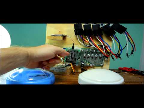

  • RagtopRagtop Posts: 406
    edited 2013-08-16 10:05
    A diagram I worked up to help in the wiring of the relay control board.
    792 x 612 - 191K

    This relay control board is mainly for head banger, spotlights, and airhorn.

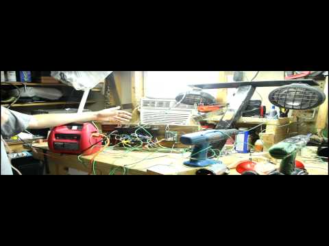

    One of the simpler props being added.

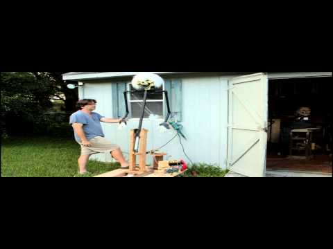

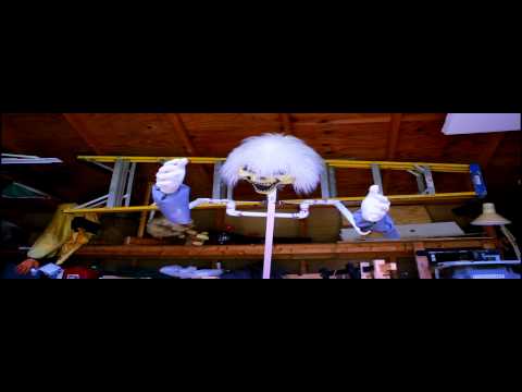

    edited 2013-09-08 17:20
    Spectre on the control board. I am using a reed switch with a magnet on the "backbone" to determine when he is in the back position to tell propeller to
    turn motor off. Works most of the time, but sometimes he bounces back forward.
    A chord attaches the shoulders to the building, pulling the shoulders down thru a pulley, bringing the arms up.
    The chord seems to yank him back before the arms come up, which wasn't what I was envisioning, but it will work.

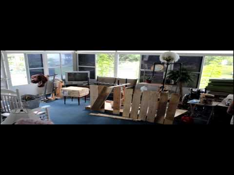

    edited 2013-09-15 12:09

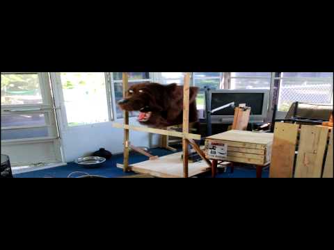

    Took over the sun room to work on the line-up. Dog is still waiting some TLC before being hooked up.

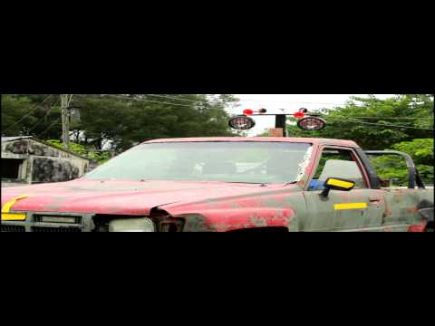

    Headbanger's pimped out ride
    I control this with a hand trigger switch that I took off a drill.
    First press turns on spotlights and airhorn
    Second press turns them off
    Third press runs Headbanger 3 seconds
    Forth press runs Headbanger 3 seconds
    then it goes back to top of the list.
    repeat

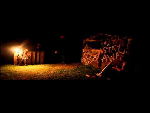

    One more night. All props finally working again, had some issues in the move. Lost my card adapter for writing
    trip wire times, but with everything else working I am going without it this weekend. Hope to work on it next week.

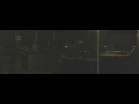

    Rehearsal. Having some issues with the sound card files getting corrupted from time to time. Can't figure out what is causing it.
    edited 2013-10-19 10:01

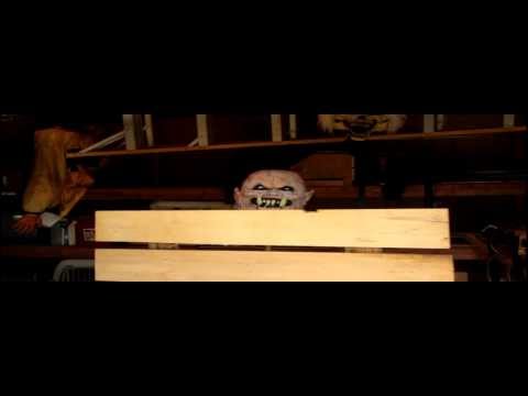

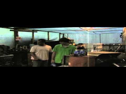

    Kind of hard to see, but the video let's me see how the sales tent worked or not. Got some timing issues to work out.
    It is hard to account for in my routine for the different speeds people come through.
