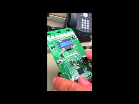

    Now we have our functional prototype boards (two of everything so we can test performance / compatibility) we've been able to start on some of the programming.
    First quick video, Chad's first draft at data-input for the badge and the gratuitous use of the 5050 LEDs:
    I'm working on badge-to-badge comms. My main aim over the next few days is to solidify which methods are most effective in a conference environment and finalize the BoM for manufacture.
    Things are starting to take shape!

    Nice looking prototype. Looks like 2 AA batteries for power? Are you running the prop direct from the batteries? Do you have a pullup on reset, and a jumper to disable the brownout? (this will let you fully run down the batteries but reduce the maximum safe clock speed.) Are unused pins and the power rails brought out to a surface mount or through hole pad somewhere? (makes hacking and extension much easier.) Have you seen the text entry mode that "The Big Picture" mode of Steam uses with direction pads? It looks quite fast and easy to use while not using up half the screen.
    Marty
  • __red____red__ Posts: 470
    edited 2013-09-04 12:04
    We're using a 9V battery as the display requires 9V or a whole bunch of passives to implement a charge-pump. We're working on the principle that since we need 9V for the display, 5V for the LEDs and 3.3V for the propeller it was easier to start with 9V and go down than start with 5 or 3 and go up.
    We've had the prototype running for almost a day so far with LEDs and TWO displays running with the prop at 40Mhz without any sign of battery weakness at all.
    As for pull-ups on reset and brownout no. As 3.3V will be the last to die it won't really be applicable in this design but in other prop designs i've done which run on watch batteries, "premature brownout" has been a recurring problem for me. I'd love the information for that for my future watch-battery designs!
    Thanks,
    Red

    I always figured the LDO leakage would eat the 9V battery. Maybe you're leading a charge here (or a good dischage at least). My personal favorite propeller battery solution is 3AA NiCads at 3.6V nominal. I found 2AA's with a boost converter make a really good power solution if 3.3V is all you need.
    I'd like to hear more about using 2 AA's without a boost converter and/or a coin-cell with Propeller. My own coin-cell experience didn't work out very well :)
  • LawsonLawson Posts: 870
    edited 2013-09-04 17:28
    Well, I've booted a Prop from EEPROM at 1.4v. So that means the boot code runs correctly at RCFAST and the EEPROM reads data correctly. To enable low voltage operation, you need to disable the internal 2.7v brownout detector, and add a pull-up to the reset pin as the brown-out detector isn't pulling it high anymore. I've had a program running at RCSLOW on as low as 1.0 volts. No point in going lower though, as the pins can only source a few micro-amps at 1.0 volts. (see the link in my signature for details).
    why are the LED's run from 5 volts? The blue LED's should only need 2.7-3.0 volts. With a regulated 3.3v supply, just the ~25ohm pin resistance should be enough for the blue LEDs if a FET is used for color select. My point here is that with only one regulated supply rail, it's easier to put a switching supply on the board and get 2-3x more battery life. I've seen several switching supply chips with integrated FETs and <100uA quiescent current. For example the LT1934 or LTC3631 have quiescent currents <15uA. But for you a higher quiescent current, cheaper part is likely a better choice. (the RT8297 looks interesting, but it's in a 0.5mm pitch DFN package, yuck!)

    The OLED actually "requires"(0) 9V (although it will happily function all the way down to 6V) so we just went for it.
    We didn't have much time (3 weeks) to get a working prototype so we went REALLY simple. We avoided [QD]FN because using leadless means adding X-ray inspection to the assembly process and that's cost prohibitive for our lowly budget.
