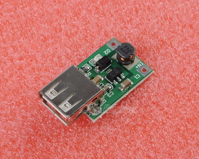

    Under a buck!!! So the only way to use these is to waste a USB cable?
    edited 2014-07-16 21:44
    NWCCTV wrote: »
    I think you ought to read post #29 again. Erco didn't cut a USB cable, he cut the board after removing the USB connector.
    I also removed the USB connector from one of my boards which was easier than normal since only two of the six places which would normally be soldered had been soldered.

    In the thread about aluminum wallets, I found a photo of my boost board with the USB connector removed.
    Here's a close up of the boost board (from a photo found on my hard drive).
    I was using a piece of orange electrical tape on the back of the board to prevent shorts.
    I ended up not needing 5V in the wallet project so the board it waiting to be used in another project.
