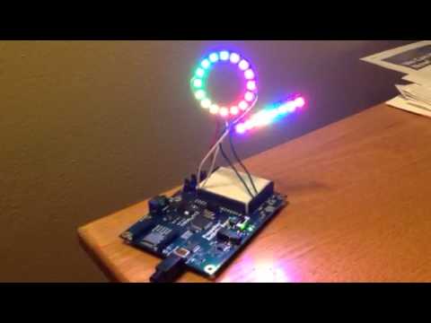

After looking at JonnyMac's jm_ws2812.spin driver it looks like the only thing needed to make the driver for the WS2811 LEDs instead is to comment out the routine fix_colors which moves the color bytes for red and green.
Robert
All I did was add another parameter and a TJZ to skip over that code if the parameter is not set. The parameter gets set for swapping R and G.
I've never seen WS2812 style LEDs that DIDN'T require the swap. In my WS2801 code, there is a swap parameter. I'll add that to my WS2812 code (later -- have to prep for Hacakday event).
I think I have Jon's single-shot update mode working in my C code but I'm having a bit of trouble with calls to ws2812_execute that are too close together. Can anyone see the problem? If I add a delay between the calls then things seem to work okay. First, I'll show some of the C++ code I've been playing with to support the single-shot driver.
Here is my test program. It uses two animation classes: ws2812_FillWheelDim fills a color array with a rainbow of colors and rotates the rainbow on every update and ws2812_Chase does Jon's chase effect. In this program I'm using two AdaFruit LED devices, one 16 LED ring and an 8 LED strip. The ring is being driven by the ws2812_FillWheelDim animation (matching my Christmas ornament from last year) and the strip is being driven by the ws2812_Chase animation. Each device is on a different Propeller pin illustrating that more than one chain of LEDs can be managed by Jon's single-shot update mode.

Here is the PASM code that is invoked when you call ws2812_execute(). I've also attached a .zip file containing all of the code including the C++ class definitions for ws2812_FillWheelDim and ws2812_Chase. These are in test.cpp which is a file I've been using to test a C++ animation interface.

I figured out why I needed the additional delay. I had inadvertently left some debugging code in my version of JonnyMac's driver. Here is a working version of the driver that actually matches Jon's code better as well.
#include <propeller.h> #include "ws2812.h" #define LED_PIN 15 #define LED_COUNT 16 #define LED2_PIN 14 #define LED2_COUNT 8 uint32_t Chakras[] = { COLOR_RED, COLOR_ORANGE, COLOR_YELLOW, COLOR_GREEN, COLOR_BLUE, COLOR_INDIGO }; int Chackras_count = sizeof(Chakras) / sizeof(uint32_t); int main(void) { int cog; // 16 LED ring uint32_t colors[LED_COUNT]; ws2812_FillWheelDim wheel(colors, LED_COUNT, LED_COUNT+5, 128); // 8 LED strip uint32_t colors2[LED2_COUNT]; ws2812_Chase chase(colors2, LED2_COUNT, Chakras, Chackras_count); // animation array ws2812_Animation *animations[] = { &wheel, &chase }; if ((cog = ws2812_init()) < 0) return 1; for (;;) { for (unsigned int i = 0; i < sizeof(animations) / sizeof(animations[0]); ++i) animations[i]->update(); ws2812_execute(LED_PIN, colors, LED_COUNT); ws2812_pause(10); [COLOR="#FF0000"]// why is this needed?[/COLOR] ws2812_execute(LED2_PIN, colors2, LED2_COUNT); ws2812_pause(100); } cogstop(cog); return 0; }Here is the PASM code that is invoked when you call ws2812_execute(). I've also attached a .zip file containing all of the code including the C++ class definitions for ws2812_FillWheelDim and ws2812_Chase. These are in test.cpp which is a file I've been using to test a C++ animation interface.'' Modified for use with PropGCC by David Betz '' Derived from: '' File....... jm_ws2812.spin '' Purpose.... 800kHz driver for WS2812 LEDs '' Author..... Jon "JonnyMac" McPhalen '' Copyright (c) 2013 Jon McPhalen {{ // parameter structure typedef struct { uint32_t pin; uint32_t *colors; volatile uint32_t count; } ws2812_params; // driver header structure typedef struct { uint32_t jmp_inst; uint32_t resettix; uint32_t bit0hi; uint32_t bit0lo; uint32_t bit1hi; uint32_t bit1lo; uint32_t swaprg; } ws2812_hdr; }} pub driver return @ws2812 dat org 0 ws2812 jmp #get_cmd resettix long 0 ' frame reset timing bit0hi long 0 ' bit0 high timing bit0lo long 0 ' bit0 low timing bit1hi long 0 ' bit1 high timing bit1lo long 0 ' bit1 low timing swaprg long 0 ' swap r and g clear_cmd mov t1, #0 ' clear last command wrlong t1, par get_cmd rdlong t1, par wz ' look for packed command if_z jmp #get_cmd mov t2, t1 ' get pin and t2, #$1F ' isolate mov txmask, #1 ' create mask for tx shl txmask, t2 andn outa, txmask ' set to output low or dira, txmask mov ledcount, t1 ' get count shr ledcount, #8 ' isolate and ledcount, #$FF add ledcount, #1 ' update (1 to 256 leds) mov hubpntr, t1 ' get hub address shr hubpntr, #16 ' isolate temporary mov t1, #0 ' clear last command wrlong t1, par rgbmain mov bittimer, resettix ' set reset timing add bittimer, cnt ' sync timer waitcnt bittimer, #0 ' let timer expire mov addr, hubpntr ' point to rgbbuf[0] mov nleds, ledcount ' set # active leds frame_loop rdlong colorbits, addr ' read a channel add addr, #4 ' point to next ' Correct placement of color bytes for WS2812 ' $RR_GG_BB --> $GG_RR_BB fix_colors tjz swaprg, #shift_out ' skip if R and G don't need swapping mov t1, colorbits ' copy for red mov t2, colorbits ' copy for green and colorbits, HX_0000FF ' isolate blue shr t1, #8 ' fix red pos (byte1) and t1, HX_00FF00 ' isolate red or colorbits, t1 ' add red back in shl t2, #8 ' fix green pos (byte2) and t2, HX_FF0000 ' isolate green or colorbits, t2 ' add green back in ' Shifts long in colorbits to WS2812 chain ' ' WS2812 Timing ' ' 0  0.35us / 0.80us ' 1  0.70us / 0.60us ' ' WS2812B Timing ' ' 0  0.35us / 0.90us ' 1  0.90us / 0.35us ' ' At least 50us (reset) between frames shift_out shl colorbits, #8 ' left-justify bits mov nbits, #24 ' shift 24 bits (3 x 8) :loop rcl colorbits, #1 wc ' msb --> C if_c mov bittimer, bit1hi ' set bit timing if_nc mov bittimer, bit0hi or outa, txmask ' tx line 1 add bittimer, cnt ' sync bit timer if_c waitcnt bittimer, bit1lo if_nc waitcnt bittimer, bit0lo andn outa, txmask ' tx line 0 waitcnt bittimer, #0 ' hold while low djnz nbits, #:loop ' next bit djnz nleds, #frame_loop ' done with all leds? jmp #clear_cmd ' get ready for next command ' -------------------------------------------------------------------------------------------------- HX_0000FF long $0000FF ' byte masks HX_00FF00 long $00FF00 HX_FF0000 long $FF0000 hubpntr res 1 ' pointer to rgb array ledcount res 1 ' # of rgb leds in chain txmask res 1 ' mask for tx output bittimer res 1 ' timer for reset/bit addr res 1 ' address of current rgb bit nleds res 1 ' # of channels to process colorbits res 1 ' rgb for current channel nbits res 1 ' # of bits to process t1 res 1 ' work vars t2 res 1 fit 496 {{ Terms of Use: MIT License Permission is hereby granted, free of charge, to any person obtaining a copy of this software and associated documentation files (the "Software"), to deal in the Software without restriction, including without limitation the rights to use, copy, modify, merge, publish, distribute, sublicense, and/or sell copies of the Software, and to permit persons to whom the Software is furnished to do so, subject to the following conditions: The above copyright notice and this permission notice shall be included in all copies or substantial portions of the Software. THE SOFTWARE IS PROVIDED "AS IS", WITHOUT WARRANTY OF ANY KIND, EXPRESS OR IMPLIED, INCLUDING BUT NOT LIMITED TO THE WARRANTIES OF MERCHANTABILITY, FITNESS FOR A PARTICULAR PURPOSE AND NON-INFRINGEMENT. IN NO EVENT SHALL THE AUTHORS OR COPYRIGHT HOLDERS BE LIABLE FOR ANY CLAIM, DAMAGES OR OTHER LIABILITY, WHETHER IN AN ACTION OF CONTRACT, TORT OR OTHERWISE, ARISING FROM, OUT OF OR IN CONNECTION WITH THE SOFTWARE OR THE USE OR OTHER DEALINGS IN THE SOFTWARE. }}ws2812.zip
[video=youtube_share;OmJZKRz4uGk]
