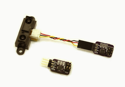

I love Sharp rangers and wishing for a digital interface, I made one. It's a tiny board that converts analog to I2C. Looking at SPI, Serial, too.
Now I can mate Propeller + Sharp rangers. Any of them.
My firefighting robot, Pokey, has few analog ports. Now it doesn't matter.
Oversampling, filtering and 125kSPS sampling produce a clean signal with reasonable bandwidth. Way better than simple ADC + averaging I've previously employed.
Is it hackable? Flexible? Yes. Easy to flash. I'm crafting it to easily bend to one's will.
I made a pseudo-theremin as a proof of concept. :) (Nerdy video here: http://youtu.be/6HEsA3RBoPc)
What would you do with one (or up to 27) of these? I want to build a radar--IRdar? Sharpdar? Might be fun to build a balancing robot. Sharp-based piano?
Sources: https://code.google.com/p/bot-thoughts-sharpi2c/

    I'm going to start a Tindie Fundraiser soon. I think others can benefit, whether from having boatloads of sensors, clean signals, no-hassle ADC, or whatever else.
    @Mickster - maybe you are thinking of the GP2D12 which has been replaced by a newer design?
    Wow, 30+ ? No problem -- I'll let you in on a secret. ;) Though I say 27 per I2C bus, I am looking at making that unlimited. The solder jumpers support 27 unique addresses. But I'm looking to make the *base address* configurable, too, either through I2C command or burning EEPROM directly. Haven't gotten to that yet. :)
    @varnon - I know Solarbotics has "I2C-it" which is a converted GP2D12. Neat idea. Mine works with any of the Sharp sensors.
    If anyone is willing to help me test 'em out, offer suggestions, and/or help me work on the Propeller I2C code examples I could be persuaded to do a short run and send you one or two. :)

    I've written a properly-behaving, pasm-based I2Cmaster object after a couple late night hacking sessions.
    It seems to be working properly with my I2C A2D module. I'll run a handful of additional tests then post up the object.
