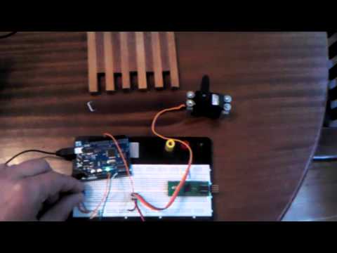

    Here's a new version of my libPropelleruino being used with the Arduino knob sample. To do that I'm using Martin Hodge's Propeller ASC coupled with TinkersALot ADC code and my Servo library. I took TinkersALot's code and Arduino-fied it to use pinMode, digitalRead, digitalWrite, and delayMicroseconds. In the process I introduced a rather insidious bug that broke his code. It turns out his delay function has a floor of 400 microseconds, while my Arduino version does not. But when I added that floor I broke my Servo library.
    I'm embarrassed to say it took me all morning to figure out the conflict because the symptom wasn't obvious. Everything sort of worked but for certain values pulseOut (which uses delayMicroseconds) would freeze and lock the cog. Anyway here's the new code:
    AnalogInput.zip
    Here's a video of it in action:
