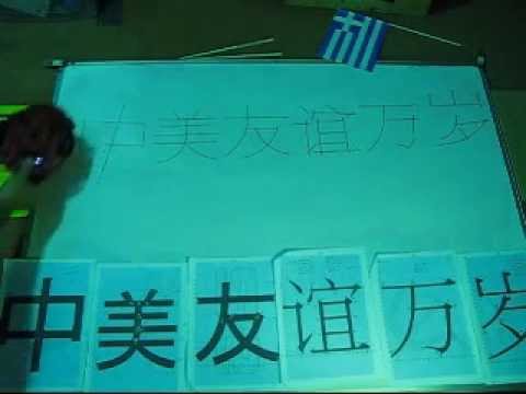

Today was a Chinese day for me. Ive just finished the Chinese project and here is the result. After a small research on the Net I found the right sequence for each character of the phrase "中美友谊万岁"
Programming the S2 I tried to obey these rules (you can check the video).
I followed the procedure with the coordinates and the excel file and here is the result:
Here is the phrase written by my S2. However characters are smaller from 30 foot because my board isnt big enough. As you can see from the video I push my S2 back to the board in order to scribble the last character! However you can change the size into excel file (I think that 25 or 30 would be ok)
At the end of this post youll find a zip file with the spin code of each character, as well as the excel file if you want to change something. Im sure that Rich can finish the job and put all together!
Next video is for Ken. I believe that he want something like this. (The Chinese background music is from this link)

This is all Simplified Chinese, not Traditional characters.
Erm, are these supposed to be displayed in Mainland China? If so, then Simplified Chinese is correct as they are the standard Beijing Mandarin Chinese. However, if these are to be displayed in Taiwan, then Traditional Chinese characters ought to be used.
In Post #1, Ken said this is what was requested.
But in responding to my first post (Post #7) he said something about wanting traditional stroke sequences.
My take is he wants the Simplified characters written as if a traditional brush stroke sequence was used.

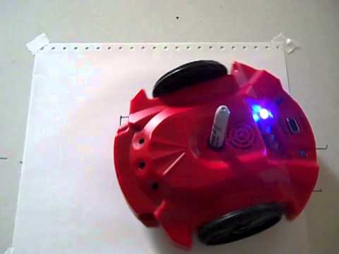

Here would be another solution i am working on now (a different project i might add - this i an 8X8 bit character payload) .... at moment i am modifying it to sport a 16X UV_Bar (meaning 16X16 bit graphic character payloads)
That is a great presentation with the UV. Does that require a special ink?

Umm, have you verified the actual brush counts and the correct direction of writting strokes. IN that reference diagram, many boxes have more than one brush stroke.
For instances, your first character is as follows:
1. First stroke is down.
2. Second stroke is top across from left to right, and down of the right side
3. Third stroke is left to right (I think you got right to left) to complete the box
4. Fourth stroke is down the middle.
I realize this makes it all the more tedious, but the errors are obvious to any and all Chinese from elementary school on.
There are dictionaries that list the exact brush stoke counts, but there are also tutorials on the set of rules that apply.
And so a simple box is actually 3 strokes, not 4. And one cannot simply go clockwise or counter-clockwise. It is top to bottom and left to right.

No special ink..... just a sheet of Phosphorescent vinyl...... the sheet is mega sensitive to UV light, a 1 second flash of UV from a UV led is enough to create a dot on the sheet that lasts for maybe 1 hour before fading slowly away.... to be used again. UV lasers have a much more dramatic longer lasting effect.
So you could easily write Chinese brush strokes that would just fade away after a period of time. That is quite attractive as a graphic demo in a crowded dimly lit room, or outdoors at night.

Thanks for all of your indications! Actually I was waiting your feedback for improvements.
I was sure that I have done many mistakes as it was only One day project about 8 hours.
Actually I spend most time in order to print each character and find the coordinates, capture the video etc.
I had also a small accident as I had to replace the mini servo of my S2s pen lifter. My research on the Net about Chinese writing was only a half hour.
Gareth,
I saw your video: How to Epicycloid A Robot with Ultra Violet Leds - Using an S2 Parallax Turtle.
It is a really cool job!
I noticed that you have done dots in different size (some dots are bigger from the others). You can really control the size (the diameter) of the dot? Can you create dots in four different sizes? E.g: Very small , small , normal and bigger ?
My question doesnt have to do with the chinese project.
I try to scribble an Image with my S2 using different size dots, but it is difficult to make the dots with the pen.

Amazing: not only printing the strokes, but in the correct order! You've done a great service. Ken's Chinese friends will truly be impressed!
Oops sorry! So used to the writing style that forgotten to write them in strokes & not in characters. I'll do better next time
Only one item that you might want to consider.
A. The First character is Zhong and that central line should be perfectly vertical.
So, the final sentence should be "中美友谊万岁“.
Please don't be offended, that first character makes a huge first impression.

@Nikos
Oh, of course that box is an exception to the general rules, just like the stuff you learned about English in elementary school.
http://www.zhongwen.com/shufa/
And here is a link to animated brush stroke demonstrations that you can cut and paste in characters you want to learn
http://lost-theory.org/ocrat/chargif/
There is a special paper that is made for Chinese students to practice brush stroke calligraphy. Instead of using black ink, you just use clear water and the image disappears after it dries out. This allows parents to avoid all the mess of piles of inky paper, ink spills, and dirty brushes.
You are on to something useful for Parallax promotions.
Im still trying to understand the philosophy of this amazing way of writing!
The more I learn the more I love it! As Humanoido said : Chinese writing is full of flavor, culture, connotation, history, reference, style, prose, subtlety, current events, etc.. So any approach demands attention and a deeper examination!
In any case the topic is an amazing school project that combines History,Chinese language, artistic skills, computers and robotics, and mathematics!
I also have in mind a completely new approach of this amazing challenge. I believe that the key is to create SPIN code for the different Strokes.
Then we can create any character putting the appropriate stroke in the right place inside the imaginable BOX of the character.
Anyway I must see more videos about this topic. Any suggestion is welcome!
Thank you for the suggested links!
Ill try to create a new version of the phase taking into account what you said till the timeline given by Ken.
Nikos
Gareth,
