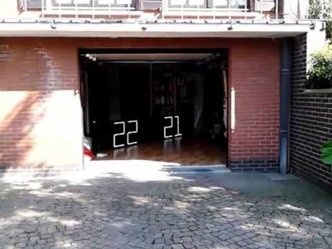

My local soccerteam needs a large messageboard (for score and massaging stuff)
Since this has to be viewed at a large distance, the board will be at least 5m wide (70cm high)
So i start this project with 12 (or maybe 10) displays (each display consists 16 ledstrips, like a 16 digit display)
Uploaded some pics here:
This has to be the final product. ( i like photo editing software :smile: )
And from a distance...
My first 2 displays, 10 to go ....
(almost 2 meters wide, 60 cm high) Tv is a 27 inch one)
wired the ledstrips...
And the drivers, need 3 of them.
some test with my first design...
And of course, it will be controlled by a propeller.
Video is coming up later...

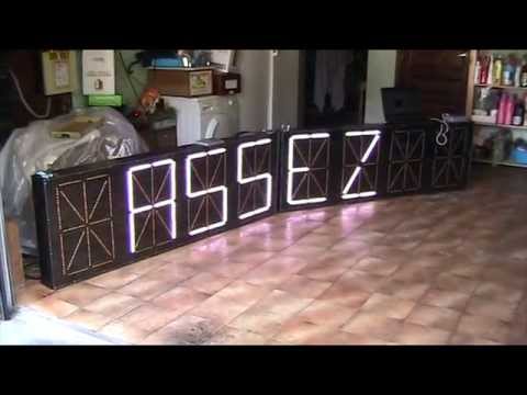

    Finished my first panel, http://www.youtube.com/watch?v=g0ntRBnoI2I&list=UUWYbKz2Sm27cdXqD5b6HEUA
    and i need 6 of them.
    And here is the driver pcb, can drive 4 displays (4 letters)
    4 layer pcb
    Almost finished my second panel, just need to connect it to the driver pcb and make a small program for the propeller.
    Will upload a movie later this day
    804 x 440 - 102K
    pcb.jpg 102.4K

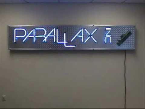

    Hey Tumbler,
    I really like your your sign project. It'll have tremendous visibility, a useful purpose, and represents a great connection between community and technologists. I'm inspired to build something again.
    Here's a different implementation of a neon sign project I built about ten years ago. Jon McPhalen provided the BS2p24 code.
    http://www.parallax.com/tabid/336/default.aspx
    And a video:
    I'll continue to read this thread regularly.

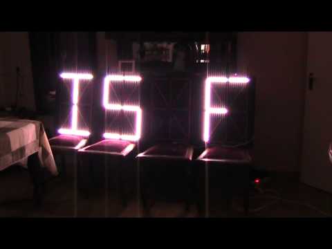

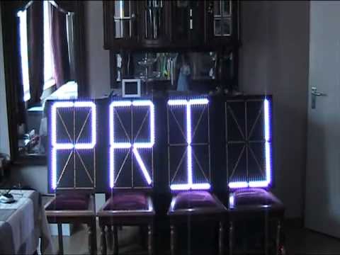

    So i did some tests and uploaded a new movie.
    I like the 'carrousel' sub and the 'independence day' test
    The 'that's why...' text is coming from a sd card.
    I hope to finish the next 4 displays this weekend.
    Today i contacted some guy who is making a waterproof housing for these displays.
    video:
    And this is the code i'm using now for testing.
