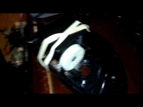

What has 3 rotary encoders, 3 limit switches, costs $3 and already works with the Propeller?
A PS2 wheel mouse with ball.
I had this idea the other day that I could rob the parts from a ball-mouse and use them as feedback for a closed loop motion control system driven by the Prop. As luck would have it, I got a surplus ball-mouse from Church this afternoon.
When tearing apart disused inkjet printers, it's become a lot more common to see a servo controlled print head with linear encoder instead of stepper motor. The paper feed path is the same. This actually makes a lot of sense, the linear encoder has become necessary as resolution and speed has increased, and steppers are more expensive than little brushed DC motors.
It then occurred to me that I could take the wheels out of a mouse and drill them to fit the end of a ball screw, or a pulley on a belt.
The mouse driver on the Propeller performs 200 samples per second, 5ms resolution. That's pretty decent when you consider a speed like 100ipm is 60 x 100 x 200 = 1.2 million samples in that period of time. If you are using a 5TPI screw (very common) then you'd have 100 * 5 = 500 revolutions per minute and 1.2-e6 / 500 = 2400 samples per revolution.
I have a picture of the encoder wheel I'll post once I reboot (USB crashed because of some old crappy peripheral).
EDIT: Ok, I got the picture off my phone and edited it in GIMP to get something useful.
The encoder wheels in my mouse have 60 divisions per revolution. That's pretty low when you look at machine resolutions. That would amount to 60 * 5 = 300 counts per inch or 300 dpi (curious). That's about 3.3 thousandths per count, which isn't very high resolution.
Resolution could be easily increased by printing an encoder wheel on transparency material, then attaching this to a stiffer backing. You can also use scavenged parts from a printer, including the optical sensors originally used by the printer. A quick search on digikey returns this part: http://www.digikey.com/product-detail/en/EE-SX1131/OR628CT-ND/355301 which could be used for a custom sensor board.
The funny part is you could connect these directly to the Prop and avoid the mouse electronics, but the mouse provides information about delta instead of sampling directly, so you've got 3 encoder channels that are tracked by a "co-processor" that is the mouse chip.
It's a neat idea that might prove useful for applications where lower resolution isn't a problem (dog feeder?).

    I built a proof of concept of this idea, and man it works cool! The Parallax hobby servos aren't very fast, so they are a bit of a limitation with performance.
    Here's a video of the demo I made:
    [video=youtube_share;EUquqGbbxx4]
