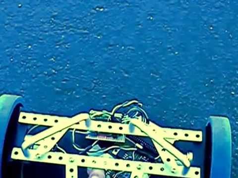

    So im really hoping to get this thing moving tomorrow and maybe even doing a figure 8, if time will allow for all that. So I sat down and threw all the hardware I need to get moving, that way I could start writing some code. Anyways I threw this together in about 20 minutes...
    It is basically a home made prop dev board connected to a 9v, and l6205 h-bridge powered by a 9.6v NiCad. The h-bridge circuit is a permanent solution, and the 9.6v NiCad is 2amp hours im not sure if it will ultimately become the main power source for this bot or not.
    1024 x 768 - 86K
    edited 2013-02-21 17:16
    I spent a few hours fighting this thing, trying to figure out why my motors weren't moving, only to find out the 9v I was using to power the prop didnt have enough juice to set the enable pins on the h-bridge Hi, so i just connected everything to the big NiCad. Anyways here it is first few runs, no figure 8 but its coming. I just did a straight run up a hill and speed bump at about a 4v PWM, and then some circles at about 2vs or so. I also ran the bot as slow as I could inside but due to the gearing it stalled on socks etc, I think a current feedback loop could easily get past the gearing issue on the stingray.
    edited 2013-02-21 17:27

    Thanks guys its nice to see it rolling around, but it is still only a very small baby step in the big picture, long ways to go lots of code to write and hardware to build!
    LOL, about the camera, its the ROM on my phone, im not sure why but it wont let me adjust my camera brightness/color although it does everything else better.
    As far as remote control goes im really just not sure what I want to do yet, I haven't received my nordic modules yet but im not sure if they are really where I want to start for wireless, I didnt realize they were not transparent serial devices. I have this little thing called a zipitZ2 you can get for about 30 bucks, it has ttl serial, wifi, usb, etc Im thinking about putting it on my bot to had a screen for visualizing data and running a debug terminal, but I could also plug a BT key in to it as well or an AdHoc WiFi connection. I think for now the easiest answer would be transparent serial over BT with my phone. Already have an app written specifically for serial robot control, it even lets you send custom serial commands.

    Hardware wise, a propeller and an l6205 H bridge chip, Software I just wrote a simple spin program around Kyes dual pwm object done in pasm. A lot of this stuff will change. Kyes object is nice, but it only allows a max of 8khz for the duty cycle, this gets rather noisey at low speed in the 1 and 2 volt range.
    I plan to implement my own PWM code at some point, Im no where near the skill level with the prop I want to be to do this though. I wrote my own duty cycle routines for a 32khz pwm controller for Arduino, originally intending to use it as the main motor controller in my project, ive come to my seanses since then though :)

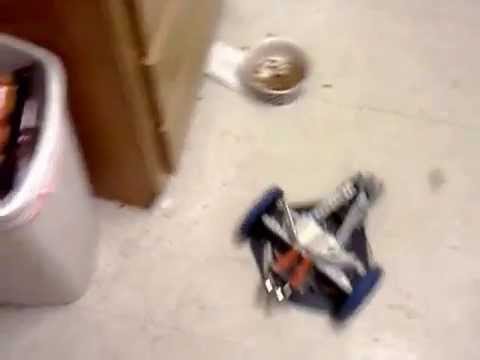

    Well I got a single ultra sonic sensor mounted and wrote some simple code to back up a foot and turn, just as a test. This will work a whole lot better with more pings, this way I don't get so many bad ultrasonic bounces and and i can make a logical decision about which way to turn. I have a video to upload, i may do it tomorrow or just wait till I have at least 3 pings on the bot.
    EDIT: Aww what the heck, here it is. The bot smacks a trash can at the end, I think I did a decent job for whipping this code up in 20 minutes or and so being it is the first robot Ive ever programmed.
    I really cant wait to get encoders on this bad boy, I have so many ideas for them. I really need to get Blue Tooth up and running first so I can manually control the bot though. Ive just been having a hard time setting the BT module up, I really need to change the baud rate. The eb301 module I have is much more complicated than those cheap e-bay ones.
