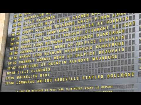

Fun service problem: We had one display that never did work right in a scrap yard. After about eight months we realized it worked fine when they weren't operating the crane with the scrap pickup magnet. The flip digits are very finely balanced to minimize the coil current necessary to flip them, and from a hundred feet away the crane magnet would flip the scoreboard digits. We put in one of the then-new superbright LED displays and never had another problem. Nowadays we never see the flip digits any more.
There is still a marke for electro-mechanical where very big signs need constant update and the power wasted in LED lights is an issue. Well lit airports, subway stations, and train station still are using this techonology.
