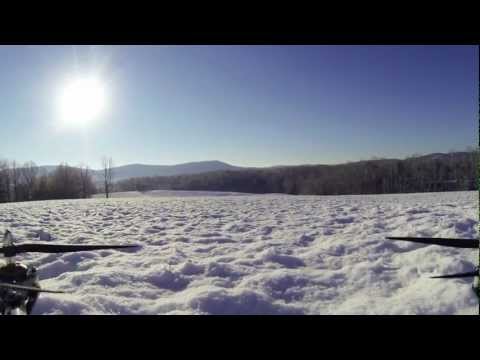

I recently assembled my Elev-8. When I mounted my go pro i realized how much my copter vibrates. Possible cause could be propeller balance is off. I did notice when installing the props it was very difficult to mount them in a way where they didn't slightly wobble. The the bushing that goes in the propeller is only inserted in the bottom and leaves a little play in the hole in the top. Does anyone here have any solutions to reduce vibrations in this craft?

    You can hear it too. I did notice the wavy distortion in the video as well but that is not what's going on here. You can hear it on the video as well and feel it during testing when I bench test the copter.

    The motors run well without the propellers. When you spin the props by hand, you can see the propeller spinner/collet wobble up to a millimeter from from the verticle axis, therefore about 2 millimeters when prop is spun 180 degrees from the start point. I may see if I can find some more precise collets online, as the stock ones just don't cut it. That would make a big improvement. In my opinion the waviness in the video is made worse by the fact that the camera is vibrating. If I can smooth out the vibration, I believe it will help video quality. I'll post back if I find some results. The camera is mounted on top of the red elev-8 top plate. I will provide video once I get back in town.

    Yes the spacers are in. The spinner and collet is the issue. The collet is mounted directly on the motor shaft and tightened with the spinner nut, both of which should be perfectly vertically aligned. The wobble is in the collet not the prop itself. Here's a video which may show what I'm talking about. I would like to show a video of me manually turning the prop but this is the best I have since I'm out of town.
    P.S. I can't wait to upload the full video. Shot on a cold morning after 4 in of fresh wet snow. Kinda cool.
    The spinner in your video looks like it wobbles. I wonder if you received a bad batch?
    Once you take some photos/video you might want to contact Parallax customer service to see about a replacement.
