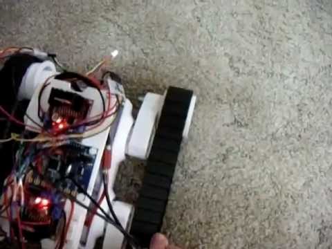

    Here's a close up view of the inside of the treads.
    It doesn't look like the spikes will need to be removed after all. The barrel shaped wheels did the trick!
    Here's a picture of the two I've made so far.
    I also came up with a better method of keeping the gearboxes aligned than my previous attempts.
    I had previously drilled holes in the gearbox housings in order to attach plastic standoffs. This time I used 2" 4-40 machine screws in the holes. I added a threaded spacer to the outside portion of the screw with an additional nut to lock it in place (not shown).
    By joining the two screws in the center with a 1" threaded spacer, I was able to precisely control the space between the two gearboxes. Once I had the spacing correct (110mm), I used additional nuts to lock all the screws and spacers into their positions and reassembled the gearboxes. A pretty cool trick if I do say so myself.
    I haven't taken a picture of the final assembly but you can see it in the video pretty well. Speaking of video:
    BTW, I used the same parameters for speed and loop times in the above video as in this figure 8 attempt with my Mecanum wheeled Rover 5.
    The right side of the robot is using the normal wheels. The right side also only has one of two motors connected to see if not driving both ends of the tread would reduce the likelihood of the treads derailing. I don't think one verses two motors per tread affects the treads ability to stay on the wheels.
    Both sides did relatively well. Of the four times I ran the program, the treads on the left only came off twice (an improvement from earlier tests without aligned gearboxes but comparable to previous tests with aligned gearboxes). The right side with the barrel shaped wheels didn't have a single problem with the treads. I ran the loop (was a figure 8 with my other Rover 5) twice since both treads stayed in place through the first run of the program.
    This is just so weird! The rims make it more likely the treads will come off. It was even harder to remove the treads on purpose from the barrel shaped wheels. The tread on the rimmed wheels are relatively easy to remove by just getting the tread started coming up on to the rim. One the tread is on the rim, it's easy to get it the rest of the way off by rotating the wheels while pulling sideways on the tread. The barrel shaped wheels resisted my efforts to remove the tread. It kept pulling the tread back on. It was very odd.

    Here's a picture on the straighening rods I used to pull the bowed gearboxes back into alignment.
    You can also see I now have four barrel shaped wheels. I can hear it crying out to drive a figure 8.

    Here's the lastest update on the Rover 5.
    The barrel shaped wheels work great!
    I recall in my past experiences with the Rover 5 the easiest way to get the treads to come off the rollers was to make relatively tight turn. Turns with a small radius were more likely to cause a tread to come off than turning in place. The turn radius in this figure 8 is would normally peel the treads off the Rover 5 very quickly. As you can see in the video below, the treads stay put through the entire figure 8.
    I don't know what was happening at the end of the figure 8. I think my control algorithm needs some tweaking.
    I'd be very interested in seeing other videos of a Rover 5 making circles like these without losing a tread. All the videos I could find showed the Rover 5 making very short turns to correct direction or turning in place. I couldn't find any showing a Rover 5 making continuous rounded turns like those in this figure 8 attempt. If any of you know of a video showing a Rover 5 making these kind of turns please let me know. I'm not sure it a Rover 5 can make these kind of turns without being modified.
    I'm very pleased with how well the Rover 5 is now performing.

    Here are a few pictures of the completed (so far) robot.
    You may have noticed a strong similarity between the Rover 5 with treads and the Rover 5 with Mecanum wheels. (Here's the Mecanum wheeled version performing a figure 8 (same video as the one in the figure 8 thread).)
    I've been using a stacked deck to hold the battery, motor controllers and QuickStart board. It's a pretty simple process to disconnect the motors and encoders and switch the deck from one robot to the other.
    I do plan to make a second deck so both Rover 5s can be operational at the same time.
    I'm already wired up a RC receiver to the QuickStart board, but my initial test of the software wasn't successful. I should have the RC version of these Rover 5s working soon.
    Thanks again erco for setting me straight with the barrel shaped rollers. Those rim extenders I initially tried seem pretty silly now. I think the rim extenders were worth the effort for the information they provided. The only failed experiment is the one that doesn't provide data.

    Duane Degn wrote: »
    These Rover 5 robots wont start moving with a PWM below about 50% duty cycle. It usually takes about a 60% duty cycle before the robot starts moving and once it starts moving it moves relatively quick. It's just about impossible to get these robots to move slowly without encoder feedback.
    That's more of an indictment of the speed controller PWM frequency being too high IMO. Bit bang 10-20 Hz PWM to your motors through your $4 L298s and you'll see what I mean.
    Duane Degn wrote: »
    There have been a couple of times when I've been having the robot driving in tight loops that a tread has started to come off. If I drive the robot in a straight line after the tread comes partially off, the tread get pulled back to the center soon after I begin driving straight. It's really kind of freaky to watch. I'll need to make yet another video to show how this works. It's very cool.
    That's more of an indictment of the barrel rollers and how they need more curvature IMO.
    PS: You never replied about taking our twins for a week since you have all this free time on your hands. Next week OK?
    edited 2013-02-23 14:21
    Erco, don't you ever get tired of being right all the time?
    At 50Hz the wheels move at about 10% duty cycle. I hardly even need my super duper propotional feedback code now.
    Okay, once I find my other set of treads, I'm going to cut off the little spikes on the inside and make another set of rounded rollers. This time the rounding will be more extreme.

    Well it was fun to imagine the treaded Rover 5 cruising over the snow banks outside our house but the reality was a little less dramatic. The Rover 5 managed to get through the snow without too much trouble (as long as the snow wasn't deep).
    I thought it was kind of fun.
    Our camera does not play nice with audio. Everytime the zoom lever was moved it produced an audible "click". I'm on the lookout for a better camera.
    I managed to get the treads to come off on my first attempt in the snow. Warning, the audio is even worse in this one.

    I'll wait to do a figure 8 in the snow until later in the week so I can have the "8" drawn around your twins. They could each be making a snow angel while the robot drives around them.
    I thought getting a treaded vehicle to make consistent loops on carpet was hard, I think trying to get a consistent loop in snow will be next to impossible.
    Maybe I could cheat and use the switch on my radio to tell the robot when it has reached the center of the "8" and it's time to switch directions.
    I've decided I don't mind (much) a rats nest of wires on an indoor robot but I don't like have a bunch of wires hanging out on an outside bot (particularly one driving in the snow). I'll need to figure out a way of making a cover this robot.
