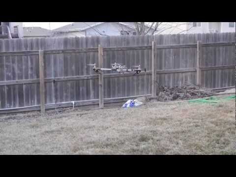

Its flying, I added a little more P and it was off to the races. There is still a lot of tweaking that needs done but I am very happy with the results so far. I will try to take a video and post it, but I am not real sure how to do that. Anyways, thanks guys. I will have more questions but I am supper excited.
Here are some pictures of my Quad, there is a picture of my 6DOF board mounted to my proto board before and after I re-supported it. Also there is a bad picture of the acrylic mount I made for my control board.
Here is a terrible video of my first flight outside. It was a little windy and I need to balance the quad and trim it also. I had to constantly apply stick input to keep it from drifting away. At about the 2:00 mark, I kind of got a feel for its drift and had some decent hover. I like how the motors sound, they run pretty smooth.
Ok, next question. I have got the quad to hover pretty stable by trimming the roll and pitch axis and also by trying to zero the accelerometer. I get very little to no oscillation during hover and if I apply pitch or roll input the quad is pretty responsive. When I let go of the pitch and roll stick the quad pops back and tries to maintain a hover and does a pretty nice job of it. However it does overshoot a little bit when it pops back to a hover. I am not sure if I have a little to much P or D in my PID. In my code the raw gyro rate is fed into my D variable and the angle of the quad is subtracted from my desired angle in my P variable. I have tried adjusting the values with little success. Have you guys seen this before?
Also I can't quite get a perfect hover it has a little drift. The D term stabilizes the quad and the P term tries to level the quad, do you guys think I could fix this by adding a little bit of the I term into my PID loop? Its like the P (proportional) can't quite get rid of the drift, but if I add I term to the PID I am thinking that the little bit of error will add up and fix the problem.
And finally my biggest problem that I can see right now. If I fly the quad in calm conditions it handles pretty good, but if there is any wind and I try to hover it freaks out and starts to oscillate really bad, almost to the point where I can't control it. It has to be in the PID's but I am not sure which part. I have heard of some very expensive commercial flight controllers having this problem. What do you guys think about this problem?
Thanks Shawn

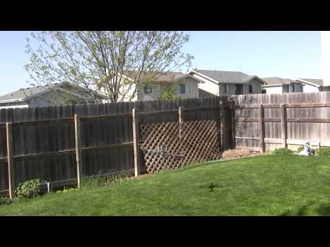

Well the wind went down luckily and I had time to take the quad outside. There was still a slight breeze and the quad was oscillating a little. So I increased the P and D values and tried again, it was pretty smooth. I still had some drift but I think it was mainly the breeze. I suppose that makes sense to have to increase the PID values, the wind would be an external force. No wind inside, so no problem. I wonder if a person should have the PID values turned up as high as possible without causing oscillation? I think if the PID values are too low there is lag in stick input.
I am super happy with this so far, I haven't really been able to push it, I have been for the most part just hovering. I still need to work on my Yaw axis, it still drifts pretty bad. That should be fairly easy to fix, or at least improve. I swear this thing flies just as good as my multiWII board, or at least it hovers as well.
I have a lot of things in the code to clean up and improve, but my brain is already thinking about heading hold. What brand of magnetometer are you guys using? I have done a little reading on 3 axis magnetometers and it looks like writing code to calibrate one is tricky.

20 MPH winds with 30 MPH gusts today. Took the quad out to see how it flies in wind since my last PID tweaks. No oscillation, which is good and obviously was not fun to fly, but the test was successful.
