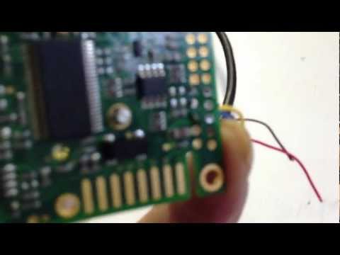

I2C_comm_guide_2_1031.pdfHi ,
After some time has passed and i tried different methods to measure the co2 level in air , today I received a new kind of sensor
its the k30 co2 sensor , in the range of 1-10.000 ppm , and uses a ndir sensor .
Before i was doing some testing with the taguchi mg-811 but this sensor proven to be not so accurate and needs to be callibrated.
anyway . I thouth it would be intrested for others wanting to connect a pretty good co2 sensor to there project.
and a good way to get some help to get it connected without too much trouble
it communicates tru I2C ,. have to find out how and what still to get the communications going ,.
anybody have any experiance with this sensor ??? hoping me and other reading can learn allot
ill be posting the working code , when I get there :P
looking for a simple object to accomplish just this first step so it seems
1024 x 1365 - 105K
1024 x 1365 - 153K
1024 x 1365 - 122K
779 x 374 - 53K

  • Igor_RastIgor_Rast Posts: 357
    edited 2012-12-27 07:38
    am using the code you supplied but the sensor doesnt seem to be responding at all .
    care to explaine where the folowing values come from , cause I cant realy relate them from the datasheet that I got
    ok found it discribed in the mobus protocol sheet of it , but still cant seem to get any usefull data out of it
    where is the start and stop bit ?
    dont I need to wake the sensor up before ?
    ' Send request for Co2 measurement
        K30.char($FE)
        K30.char($04)
        K30.char($00)
        K30.char($03)
        K30.char($00)
        K30.char($01)
        K30.char($D5)
        K30.char($C5)
    another question , I have the sensor powerd tru g0 and g+ feeding it 6 volts .
    the prop and everything else runs off 3.3v. and like i see the sensor core also runs at 3.3 volts.
    is is possible to connect it to 3,3 volt ( mayme the DVCC) to let it work on 3.3 volt . saving me to have to use the 6 volt regulator and some caps exclusivly for the sensor
    thnx
    edited 2012-12-28 15:00
    @ Bean
    I have got it working,
    Turned out , I was using 2 power supplies ,
    1 for the propeller , 3.3 volts,
    and a different one for the 6 volts that I feed the sensor with , But I forgot to connect both grounds to each other ,
    now its working fine , My sensor looks to be pretty accurate without doing the calibration ,
    So thanks allot for the example. Ill be further incorporating the sensor into my project
