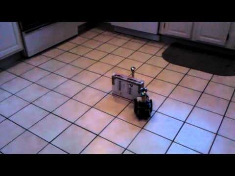

    I've done odometry projects and obstacle avoidance projects, but I haven't combined the two. However, in principal is should be that much different. You move towards your desired destination, when an obstacle is encountered move away from it while tracking your position, after a certain amount of time resume moving towards it again. Here's a video using beacon navigation, but it's not that different when using odometry.
