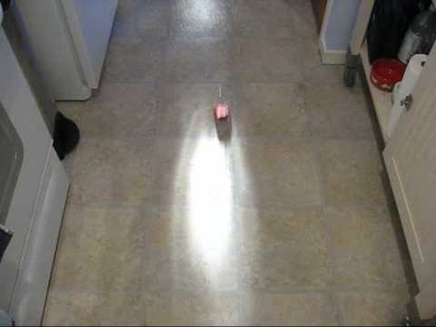

    High RPM low torque motors with small wheels have a certain appeal. I have a Herbie the mousebot which uses cassette tape pinch rollers on ungeared DC motors. It works much better than you would expect.

    Id love to see a picture of your mousebot martin..
    It's a Solarbotics kit, so you can see their video:
