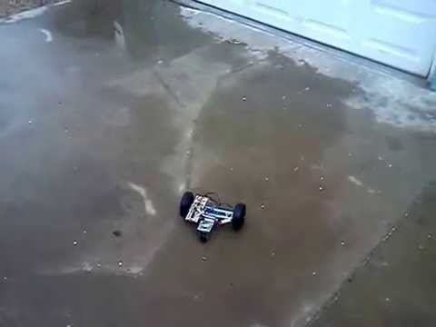

Now here is a video of a test run. The video shows the bot using open loop functions to go forward, brake, go backward, not to smart yet but the propeller will fix that
Now that you guys have seen this in action maybe someone can tell me why the robot goes fairly straight when the caster wheel is in front, but when I let the caster wheel trail, it is anything but straight!!!! I know encoders and a PID loop will fix this, but id like to get the thing going pretty straight before relying on PID, im not trying to slow my bot way down!

Part of your caster problem is weight distribution, I have good results with maybe 15% of the weight carried by the caster..
The other part of your caster problem is... well.. It's a caster...
-Tommy
agfa
I was under the impression that rear casters were more stable than forward casters. I can think of one possible reason for the straighter forward caster course.
With the caster at the front, it swings around closer to the drive wheels. There is now a shorter moment arm between the caster and the drive wheels than when the caster trails the drive wheels. This shorter moment arm is less likely to deflect the robot off course when the caster hits a bump since there is less yaw torque from the shorter arm.
Well, that's may theory and I'm sticking to it (until I hear a better one).

Makes me wonder if there are big casters where the wheel always contacts the ground in the same place in relation to the rotation of the wheel. I guess they wouldn't swing as much, take a little more power and be tough to pull out of a 90 degree angle without skidding.
I also noticed better directional stability the farther the caster is away from the center line of the drive wheels.
Thats why I use a motor to turn the wheel like a rudder. It does not seem to require much power to turn the wheel.
The wheels I use only touch the ground on the bottom, so only a small patch of rubber is making the friction.
