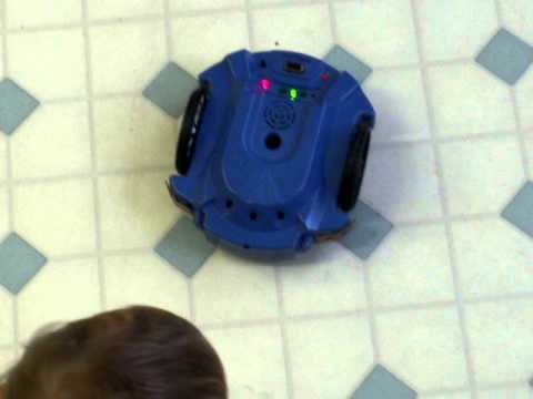

    Real continuous rotation servos have decent dynamic braking, I'm not sure about this motor/HB25 combo. Per Martin_H, shorting the motor leads together is the easy way to brake a DC motor. Adding a SPDT or DPDT relay (with nice beefy contacts) between each HB-25 and motor may be the most direct method. A quick blip of the relay disconnects power first, then shorts the motor leads together. That's what I did on the Scribbler below.
    A modification to a stock Scribbler for better odometry. It's pretty easy to see the difference when the robot stops with dynamic braking (green LED on) versus coasting to a stop with no braking (green LED off).
