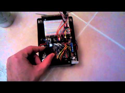

A year ago I purchased a USB proto board on sale. Ifter working on it off and on for a year I finally have something to show.
My first step was a to solder headers to match the Propeller platform, some 3.9 kOhm resistors to create 5 volt tolerant servo headers, an SN754410NE, and some screw terminals. This created a fairly capable robot control board for about $25. Here's what it looks like:
Most of my favorite robots use servos for locomotion, so I want this robot to use DC motors to branch out. An eBay purchase later gave me a vehicle where I mounted the board and a breadboard as you see above more below.
I added a sensor plate to the front and I'm working on some programs now.

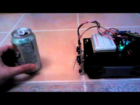

    After a fair bit of work I got PropTank working. Below is the source code archive. You'll note I have reusable classes for whiskers, QTI sensors, and IR eye sensors. In addition my motor driver module conforms to the interface used to drive the Prop Boe-bot's servos. This allows is for me to write code once and share it between Prop Boe-bot and PropTank.
    Here's a video of the tank rolling around a table while avoiding edges and trying to push stuff off the table:
    Here's a video showing how it sees a can and steers towards it.

    BTW I say a pox on acrylic again. The edge sensors had a few glitches and more than once the tank went over the edge. Three out of four times I caught it, but the fourth time it hit the ground and sustained damage to the acrylic top. I also smashed a cheap Chinese ultrasound sensor. After this video I'm laying off tables for a while.
