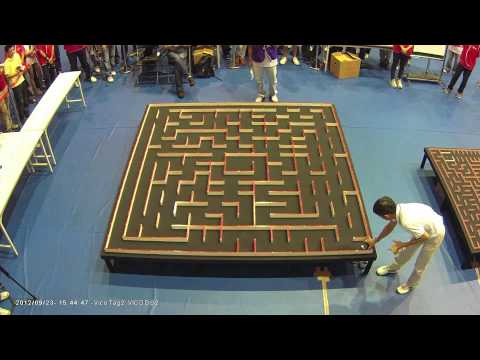

    This was done in the Micro Mouse Races in the mid/late 70's. The objective was to have the mouse travel through a maze to the exit as quickly as possible. Initially the mapping consisted of 1 bit per square area of the maze (like a pixel on a screen) with a 1 representing a clear area. Simple to program and worked well when there was an initial learning run or multiple timed runs, but as speed increased wheel slip made it less useful.

    kwinn wrote: »
    Still doing it in this millennium!

    Thanks for posting that. I didn't think maze races were still around. All I have seen lately were line follower contests.
    @Duane
    Back when I was involved memories were pretty small and expensive so the "pixels" were a square with dimensions equal to the width of the maze passages. With what's available now you could probably map your entire house at 1 inch or better resolution so there is no need to modify the furniture ;-)
