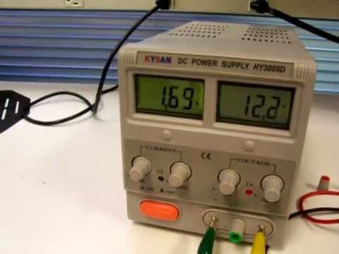

    edited 2012-11-27 08:42
    Test #2: Simple heat generation test of main drive motor under no load, and continuous duty @ full rated voltage for 7.5 hours.
    [video=youtube_share;y70SUkRWqIE] [/video]
    -MattG

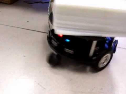

    edited 2012-11-27 10:45
    Test #3: Sixty pound load test. Spinning in place, instant motor reversals, no PWM ramp up/down, full power drive from bench-top power supply.
    -MattG

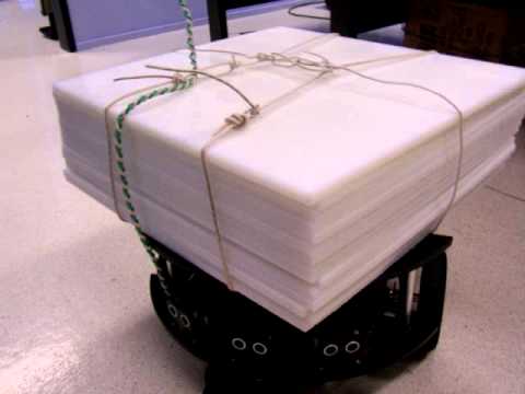

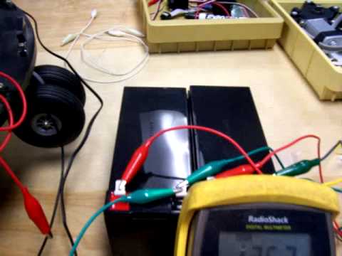

    edited 2012-11-28 09:25
    Good tests! How's it doing?
    Here you go, glad you asked :thumb:
    [video=youtube_share;NAk7GezvyAk]
    Additional test conditions:
    Ended up running just 10 minutes shy of 8 hours continuous operation, before it was turned off (intentionally - It was time to go home ;-)
    The Blue Plastic bumper (attached to my workbench) helped to keep it in the same spot for hours and hours because I did not implement any encoder feedback. Kinda like "bumper-bots".
    The constant "slinging" of the load back and forth added to the stress of the unit, but there was no noticeable degradation, in spite of this to the any parts of the machine at all.
    Unless you'all can think of something else (that I did not cover in these tests), I'd say this is pretty conclusive of the MadeUSA Robot Platform's reliability (with a 60# load).
    I'm convinced that, if the load were evenly distributed, and the terrain was flat, and you programmed the machine to accelerate and decelerate, that even larger loads could be accommodated. However, we're not going to suggest that your application won't push it beyond what it can handle - it's up to you to determine whether or not MadeUSA is capable for your application.
    Speaking for myself, I'm convinced that it'll carry this load reliably - and beyond - in fact, I'm gonna go off-road with my own machine this winter - mud and all :thumb:
    -MattG

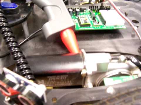

    edited 2012-11-28 09:43
    Hey all -
    Another thought: It's interesting to note that the first test (static, full on motor) resulted in a motor temperature of about 170 degrees, whereas the fully loaded final test only produced a temperature of 120 degrees or so.
    The two variables that I can think of that might explain this are:
    1) Semi-intermittent on vs. full on
    2) air circulation because of machine movement
    But even with those variables, that's a 50 degree drop from a "test bench does nothing but spin in free air" to a "real-world, 87# (60# payload plus full MadeUSA base platform, batteries, etc.)
    -Robot Torturer

    edited 2012-11-28 11:38
    If the motors were reversed every few seconds without ramping then it seems that there was no time that current was not applied, and at stall current for a moment every cycle. I can't see how that would be easier on them.
    Did you measure the temp of both motors or just one?
    edited 2012-11-28 11:45
    124 & 130 degrees at the time the machine was shut off - I think it's circulation through the air...
    -Dr. Thermo
