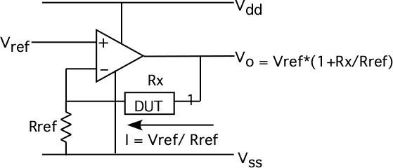

    5 mA is not much. It might be possible to float the DUT in the feedback path of an op-amp. Like this:
    The current is set by Vref and Rref, and the DUT Rx is the only unknown. Feed the output voltage into an ADC. If the ADC has a differential or psuedo-differential input, then one input can be Vref and the other input Vo, so the measurement is simply Vdiff = Vref * Rx/Rref. You can use one Vref for all the op-amps.
