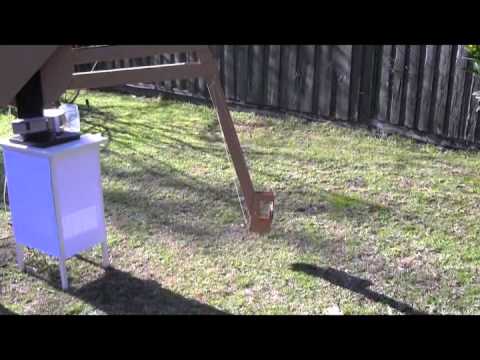

I've watched the cardboard robot arm video:
and taken a look at some of the static images:
I found his method of linking the steppers to the cardboard disk interesting. What he's done is attach thread to each end of the disk, wrap it several times around the stepper spindle. The friction from the thread on the spindle will be quite high as long as there's no slack in the line. So effectively it is like a belt drive. I think this should give the stepper a fair amount of mechanical advantage over mounting it at the center and acting on the disk axis directly. It also removes the need to make the stepper shaft and disk center concentric.
I want to try to build a stepper controlled lazy suzan using my ebay Chinese stepper motors. They're geared down, so the might have enough torque to act on the center, but acting on the edge of the disk might increase that force. It might also be easier as long as the thread has no slack.
But I figured I would ask people with more mechanical experience what they thought of this step up?

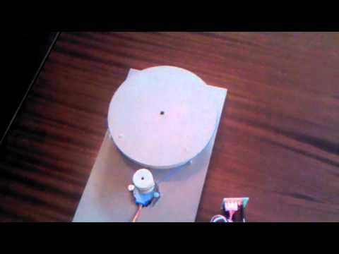

    I cut a disk for the turntable and assembled the lazy susan fairly easily. I also mounted the stepper in the middle with its shaft going into the center of the turntable. But testing showed some binding, so the stepper shaft is not completely concentric to the lazy susan bearing. It's close, but not dead center which is what I feared.
    I'm thinking that I might be able to resolve the binding by letting the stepper floating around bit on the mount. As long as it doesn't turn a bit of play shouldn't reduce accuracy that much.
    The other problem to solve is creating a secure connection between the turntable and the stepper shaft. One thought is to crimp a tube so it matches the flattened shaft and the epoxy that in the center of the turntable. The other is filling the hole in the turntable with epoxy putty and pressing the shaft into it. The idea is that the epoxy putty will harden into a shaft profile and make a secure connection.
    edited 2012-11-03 08:02
    I used a flexible shaft coupler made out of aquarium tubing to couple the stepper to the turntable. This did the trick in terms of providing enough flexibility to handle the lack of concentricity. However these small steppers don't have the torque and it stalled too easily. I was energizing two coils at a time too.
    So I'll need to try some sort of belt drive which means that these motors are likely too slow. I have some other scrap steppers recovered from old printers which might be acceptable instead.
    edited 2012-11-03 10:16
    Finally, some modest success. The ebay stepper does have enough torque to turn the turntable by pulling on a string wrapped around the edge. Here's a video
    I think that this proof of concept has gone as far as I can take it. I would need a faster stepper, better belt, and a turntable with a grooved edge to hold the belt to go further.
