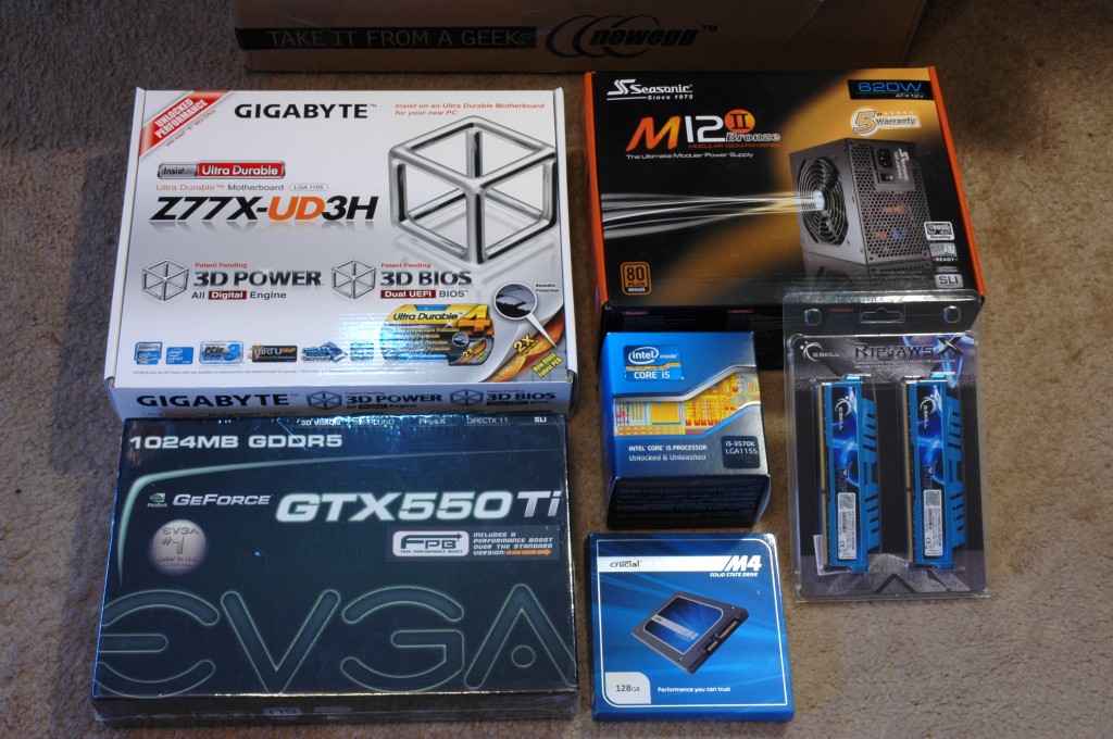

    UPS just arrived. Unfortunately, I already had plans for the weekend and may not get to mess with this stuff until Sunday or later. I really wasn't expecting it to be delivered until Monday at the earliest. I mean, it has literally been only 24 hours since I placed the order.
    Z77 LGA1155, Core i5-3570K, 128GB SSD, 8GB of RAM. I sure hope it all works, I really didn't spend enough time researching.
    I may just go ahead and order one of those LGA 775/DDR2 motherboards, they're only about $50, just to see if that's the problem (after I rule out the power supply).
