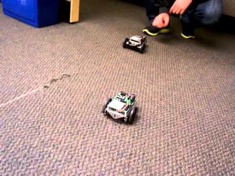

Just testing an idea...
Same power, same servos, same code...
[video=youtube_share;9PAzqughSuM]
-MattG
    edited 2012-10-25 10:45
    Same power, same servos, same code... external gearing. Nice!

    Close ups...
    -MattG

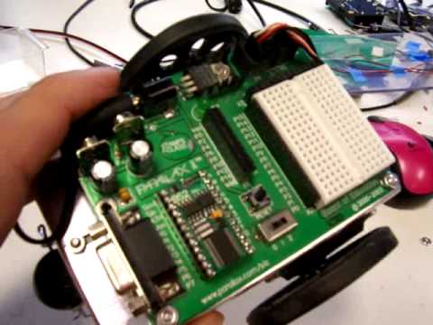

    Matt,
    I get how the servo splines are laser-cut in the spur gear, but how did you make the shaft that connects to the wheel?

    Matt,
    Looks like a 4-40 machine screw. There's a lock nut against the inner gear (the white one, which seems to be used as a spacer); the end of the screw goes through a hole in the BOE chassis to support it on that side. The wheels are held in position with a laser cut pillow block, that in turn is mounted to some undercarriage. At least that's what the 2.5 second shot of it in the video seems to suggest.
    It's tough to show, but this was truly a "guerilla-get-it done-quickly prototype".
    What I did was cannibalize two other servos and took out the final gear (that had a bearing cavity on one side). So I used that as a "detached" shaft extension - essentially the device requires the drive shaft to be aligned very closely to this final gear's shaft receiving hole - it wobbles a bit (because of slight shaft mis-allignments, but it worked well enough to prove/disprove torque question-ability.
    un-reliable, simplistic, and cheap. my middle names.
    -MattG
